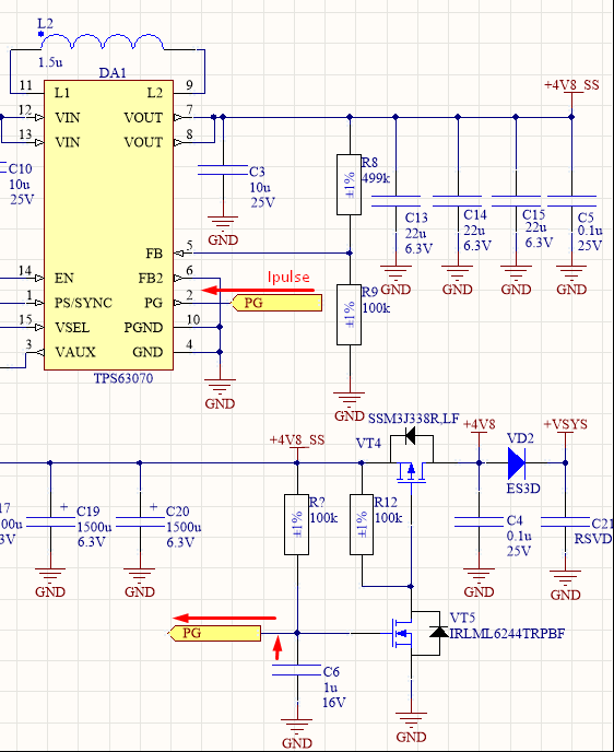

Dear Sir or Madam,
I have a question about Power good input current.
I put 6000 uF according to the load power requirements (the load is always connected to DC-DC). As a result, tps63070 can`t rich the required output voltage, so I decided to disconnect +4V8 SS power line from the load using PG and VT4, VT5. BUT, I have found that the maximum sink current to PG is 1mA, so the question is - Is it possible to discharge energy from C6 to PG pin directly?
It works in real life but i don`t know how long PG pin will be alive.
P.S. If i put the resistor to C6 in series, i cann`t provide overcurrent protection (VT4 will be overheated), that`s why i put C6 to increase rise time(as a result - reduce switching frequency)

    If I understood correctly, you are turning on the +4V8 line with a delay, after the TPS63070 reaches the nominal voltage and PG output goes high?
    The maximum continuous sink current for the PG pin is 1 mA. In your case there is only a short pulse, however, we didn't characterize this so we cannot guarantee that there will be no long term effects. Could you try adding a ~4.7 kΩ resistor in series with the PG pin? This would limit the PG current to 1 mA. It will not affect the VT5 turn-on much, but will it slow down the turn-off a little, not sure if that is critical. Additionally, you can also try decreasing C6 to 100 nF, and increasing R? to 1 MΩ to reduce the influence of the added 4.7 kΩ resistor.

    "If I understood correctly, you are turning on the +4V8 line with a delay, after the TPS63070 reaches the nominal voltage and PG output goes high?" - Yes.
    Is it possible to increase R? up to 2MOhm? I have put 4.7kOhm resistor to C6 (100nF) in series and my circuit can live without any damage during short circuit.

    Check out this app note on how to select a pull-up/pull-down resistor for an open-drain output:
    http://www.ti.com/lit/an/slva485/slva485.pdf
    When choosing the maximum pull-up resistor value, consider the leakage current on the PG pin. According to the datasheet, the PG pin leakage current is 0.2 µA maximum. This will make a voltage drop of  up to 0.4 V on R?, if you chose 2 MΩ. This is a bit on a high side, but probably still fine to keep your VT5 on.
