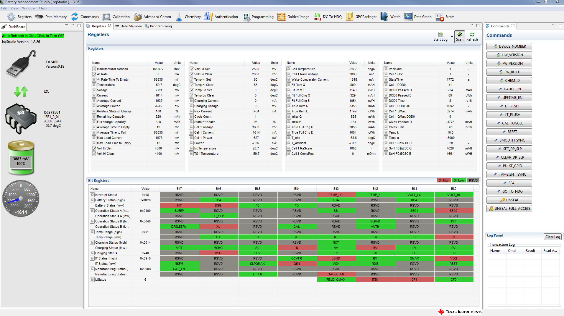

Calibrated the voltage and current for the gauge.  However, I saw that even with almost zero current draw on the battery (25-100uA as measured by an external DMM) the gauge still showed a discharge current of ~14-17mA in bqstudio.  I calibrated several times at different current levels but this value would not show zero current.  Eventually I increased the deadband current (but not the Coulomb Counter Deadband) to 15mA.
Performed a Learning cycle.  Log files and screen snapshots are attached below.  I divided the log files into their various steps to prevent them from getting too large.

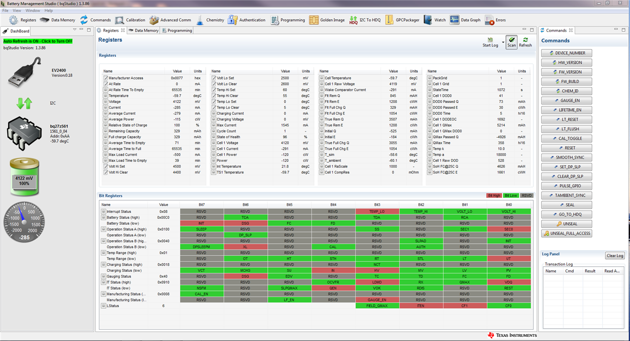

I confirmed that the REST bit was high but VOK was low and the update status still showed 0x4.
I let it sit over the weekend with at most 25-100uA of current draw.  This process completed at 9:26AM on 3/23 (line 75 in 4BatteryLearningStartDischarge.log). I took a snapshot of the bqstudio GUI ExtendedRestAfterChargeComplete.PNG
Update status still did not indicate 0x5.
The battery voltage showed 4162mV.
The available capacity indicated 92%.
The state of Health still showed 81%.
8. Started discharge to empty using between C/5 and C10 rate.
When discharge is started the REST bit went low and VOK went high but update status still showed 0x4. This process started at 9:26AM on 3/23 (line 75 in 4BatteryLearningStartDischarge.log).

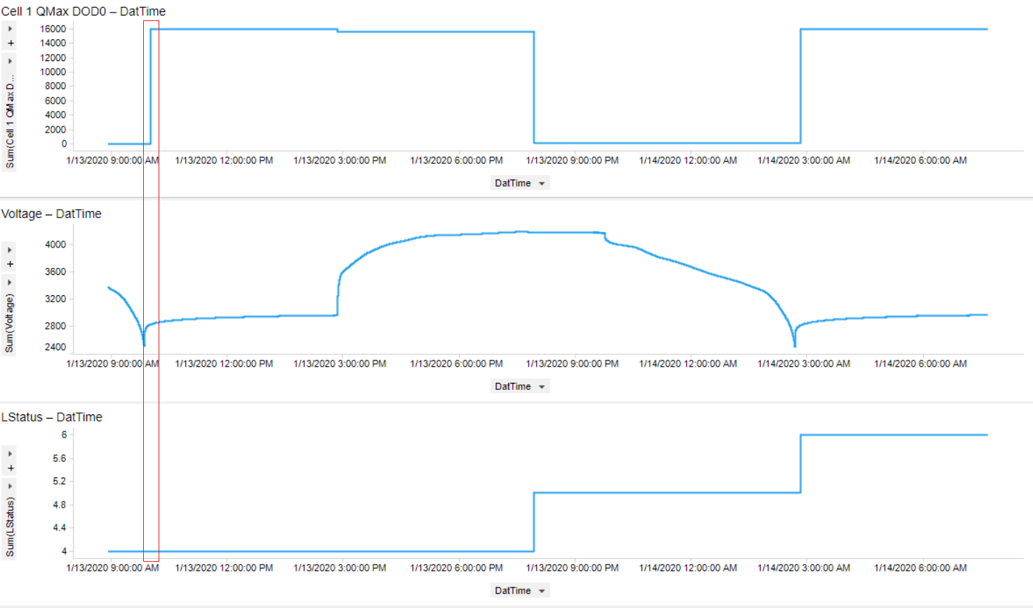

  • I have checked your log files.
    After the battery is discharged to empty and relaxed, you should be able to see the QMaxDOD0 is updated and its value should become around 16000. See the example below.
    However, I see that QMaxDOD0 was not updated correctly in the file 1BatteryLearningDischargePlusRest.log.
    You would need to run the learning cycle again.  I would suggest you use a bq27z561 EVM and also do a good calibration.

  • This 5-hour relaxation time allows for a valid OCV reading to be taken and stored for the Qmax update. The valid OCV reading occurs when the dV/dt of the battery is < 4 μV/s.  In your learning cycle, I believe this condition was met and therefore a valid OCV reading was not captured.  Try to have the battery relax for a longer time and also check the QMaxDOD0 in the log file.

  • I have now completed a successful learning cycle using the evaluation board.  The update status was 0x6, the full charge capacity was correct, and I was able to verify that it correctly tracked the battery level through a charge and discharge cycle.
    After verifying it was working correctly on the evaluation board I exported the golden image files and programmed that configuration into my custom board.  However I immediately noted that the full charge capacity was not correct.  It correctly imported the QMax (~5214mAh), State of Health (96%), and data flash values.  But it set the full charge capacity to ~300mAh even though the evaluation baord was reporting a full charge capacity of 4757mAh when I exported the golden image files.
    I then charged the battery to full and saw that the gauge reported that the battery received greater than 4800mAh of energy during the charge cycle.  However, the full charge capacity did not update.  I then let the system rest over night for > 12 hours.  After 12 hours it updated the full charge capacity upwards only very slightly to 329mAh.
    I then discharged the battery with a light load (285mA).  After discharging for ~15 minutes at this rate the gauge reported that 73mAh of energy had been discharged from the battery but it still reported both the full charge and remaining capacity at 329mAh.  See attached image of bqstudio.
    I then increased the discharge to 1614mA. After discharging for an additional ~10 minutes at this rate the gauge reported that 151mAh of adittional energy had been discharged from the battery but it still reported both the full charge and remaining capacity at 329mAh.  See attached image of bqstudio.
