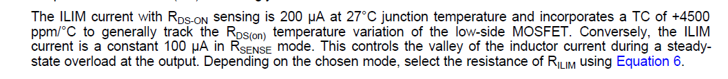

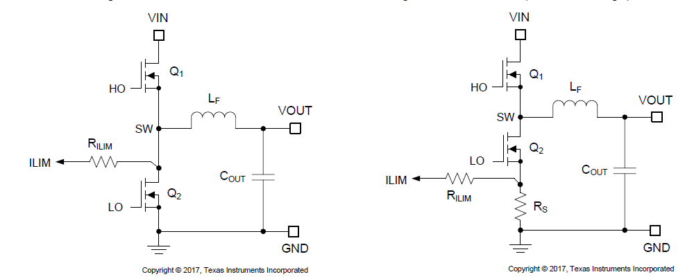

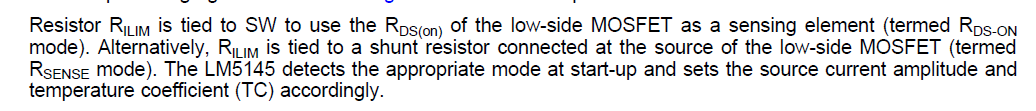

Hi Team,
While my customer is using LM5145, they have question for its current sensing mode. Whether it is Rdson current sensing mode or shunt resistor sensing mode depends on position of ILIM pin connection.
However, from the datasheet, there is no place specifying how LM5145 finds ILIM position.  Could you please help clarify from internal circuit how LM5145 knows ILIM pins therefore to select current sensing mode? Thank you!
