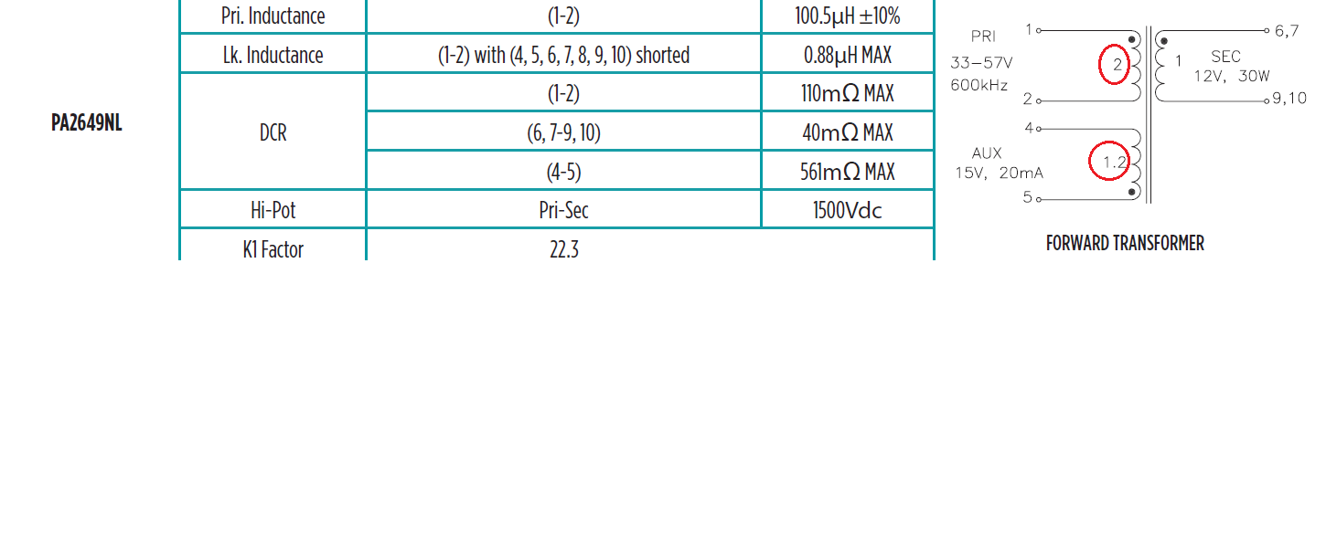

According to the specification of TPS23754, the operating input range of VC is between  8 ~ 18V.
The design of TPS23754-EVM shows that the turn ratio between the Primary and AUX of flyback transformer is 2:1.2.
How can we make sure that VC can be within 15V if Vin is up to 57V. Is there any formula to calculate the voltage
of VC? Dose it refer to Secondary winding?

    This node is switching, so the voltage is not only a ratio of the transformer. The voltage on VC is related to the duty cycle as well:
    V_c=  V_in  * (D/(1-D)  ) *  N_A/N_P
    If it helps, Think about how the output voltage of 12V is maintained for the input range. In the same way VC can be maintained over an input range.
