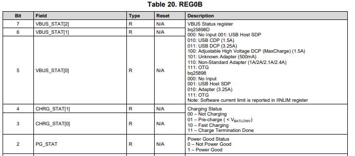

  • hello,
    When a VBUS input is lost, a 256-µs INT pulse is generated.
    At this time, is the REG0C register updated?
    Which fields can I check if updated?
    If not, in which field of which register can I see?
    best regards
    If valid VBAT is still present after VBUS is removed, please check REG0B[7:5] and REG0B[2].
    Ning.
