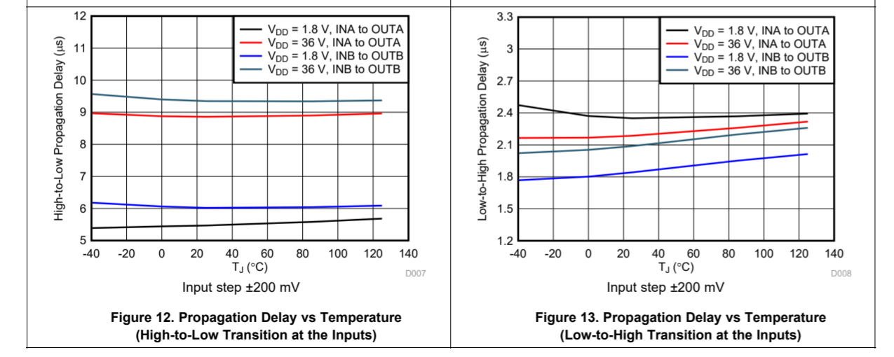

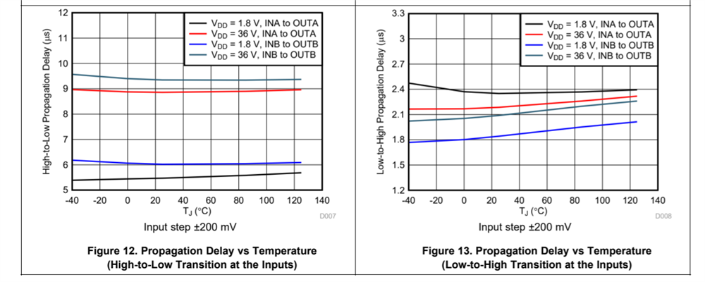

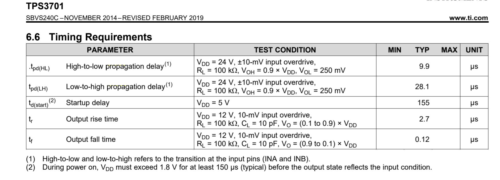

The propagation delay values given the table and graph of the datasheet doesn't seem to be in sync. Please let us know which value to consider while designing a circuit where propagation delay is critical. tPD(LH) is given as 28us in table while in graph tPD(LH) is in the range of 2-3 us.
Attached are the images of table and graph given in the datasheet and the datasheet itself. Refer Page - 6 (Table), 8(Graph)
