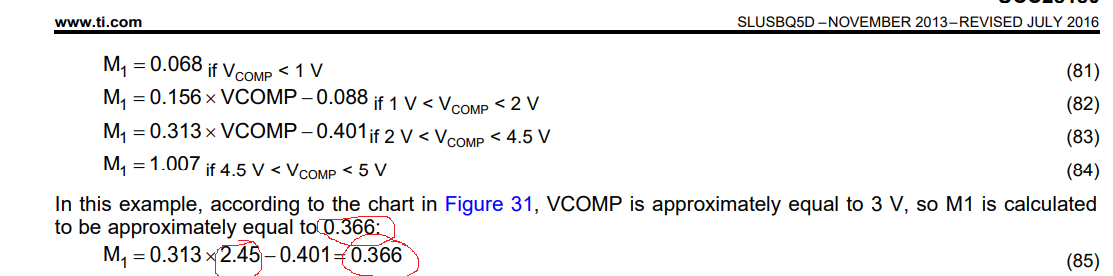

We are reviewing the UCC28180 datasheet for a new PFC design.
When we look at equation 85, we're wondering if the equation is correct.
Shouldn't VCOMP be = 3V (not 2.45V) ?
Then the solution would be 0.538V, right?
Or are we interpreting this incorrectly?
Thank you, Keith
