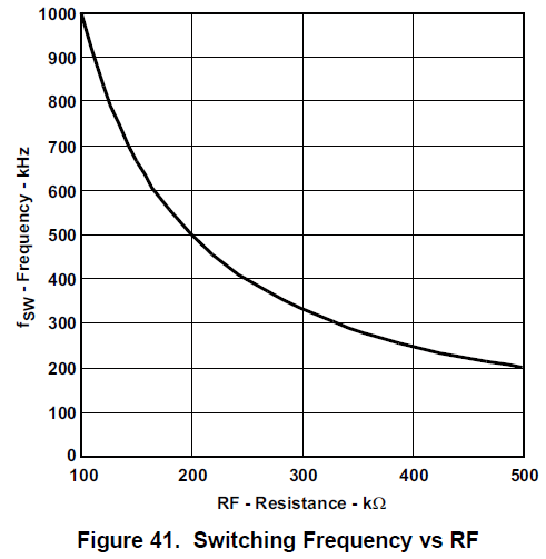

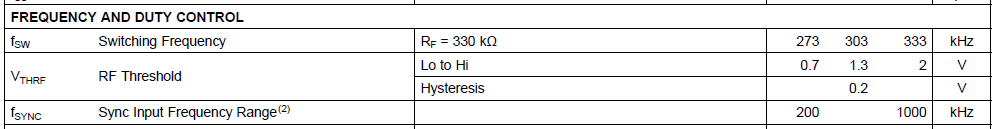

regarding of TPS51220A frequency question, may I adjust the frequency from 333Khz(MAX) to 450Khz? (RF = 221kohm)
based-on datasheet page24, figure41 (Switching Frequency vs RF). whether can be improve the frequency?
if can be do it, do I need to modify other parts value, too? (or only revise RF resistance)
