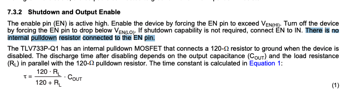

Hi Team,
Whether the the EN pin has pull-down resistance?
Since customer need to use MCU GPIO to control EN pin,this IO is high-Z.
If EN pin of TLV733-Q1 doesn't have pull-down res, whether we need to add one pull- down res in EN pin?
