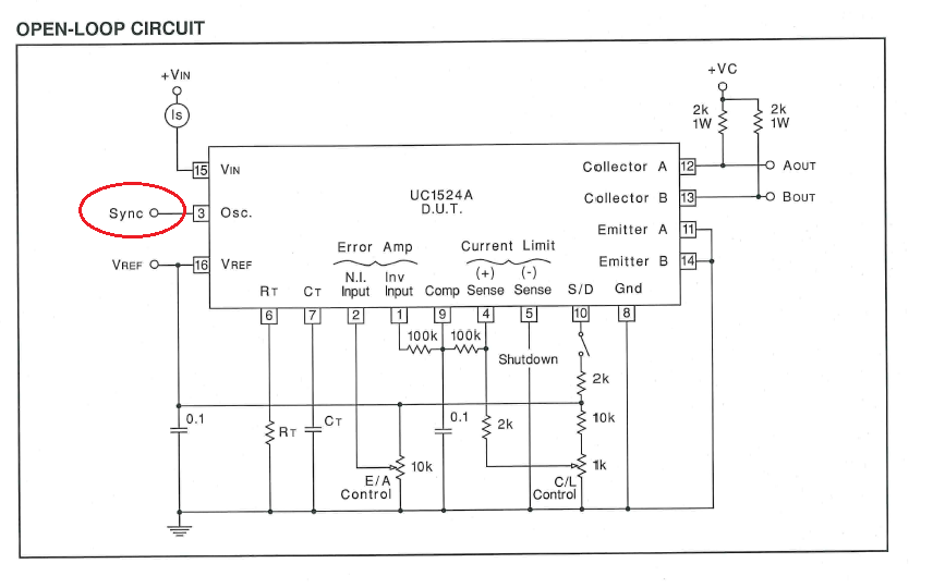

Part Number: UC1524A
I am considering using UC1524AJ883B device.
The circuit does not use the OSC/Sync pin.
In this case, can this pin be left open?
Or do I need to do anything with this pin?
Hello Kaji@PAN,
You do not need to connect this pin if you do not use it.
This is an output signal that may be used for synchronisation of the UC1524A to any other pwm controller and you can leave it open circuit
