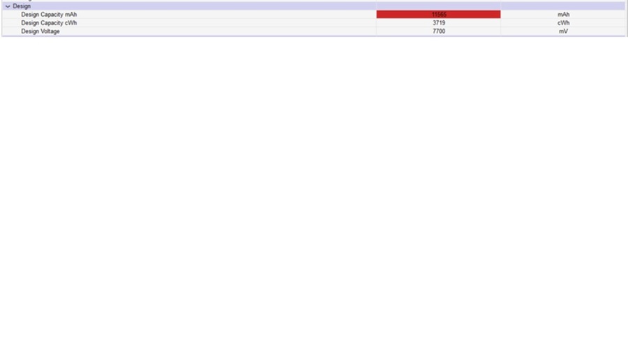

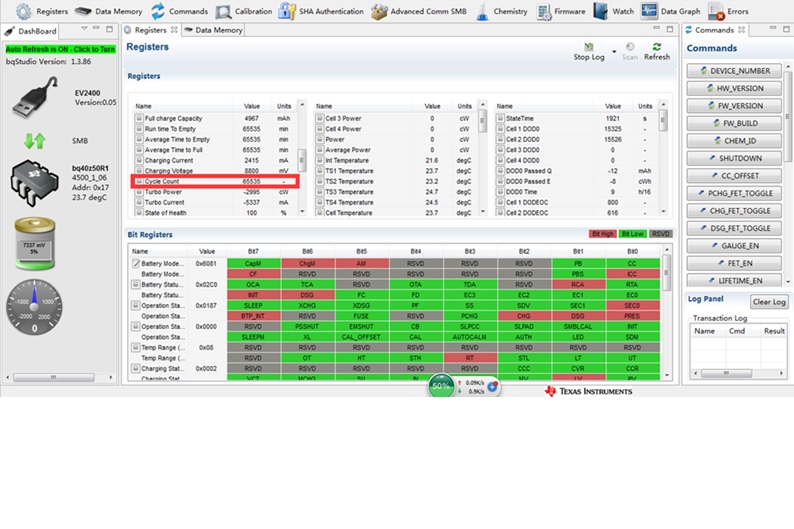

Case1. Cycle count just show once in the before products. But now the we found the cycle counts is 65535.
Case 2. The correct battery capacity is 4830mAh, but we get the capacity 11565 mAh.
This is MP product and we ship 20,000 unit. We  found the fail number is 16 pcs of 200 pcs recently.

        Does customer seal the flash before they ship the battery? I have ever seen similar case caused by not sealing the device before shipping.
        Do they check the signature of each battery before shipping? I mean is there any log information showing the data is correct before shipping

    Actually, customer didn’t seal FW before shipping due to end customers need to read gas gauge configuration in system assembly.
    We’ll also advice our customer to update the regulation on sealing FW before our shipment.

        1. If there will be lower or no defectiveness happed that we adopt the solution on sealing FW before shippment ?
            Sealing the flash before shipping is just a suggested conventional measure to be applied to the battery to exclude any possible temptation or unintended operation to the dataflash. Ideally, the issue should not occur anymore. But it is still possible to occur, for example, if the end customer's software for modifies the dataflash configuration occasionally impinged some flash address unexpectedly.
        2: Seal the device can be done by sending a command. If there is no fixture for SMBUS communication, then it can be done at host side by issuing a patch or something
