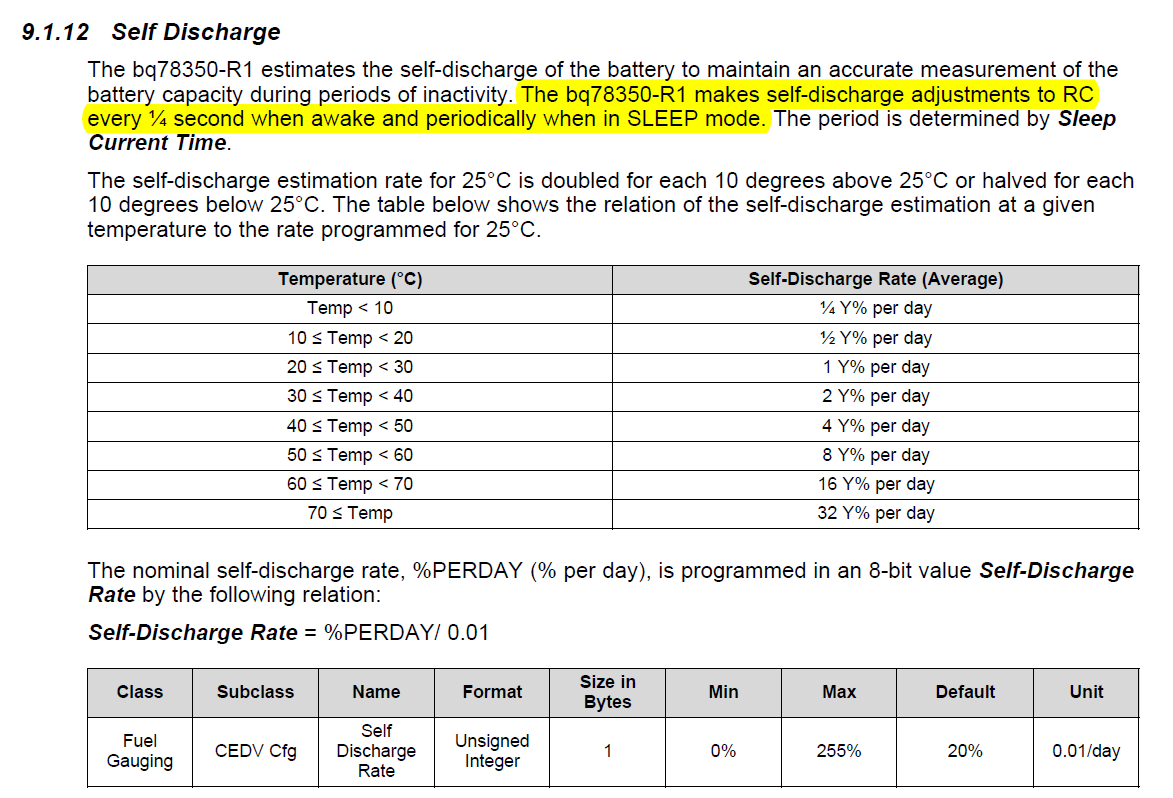

Hi Team,
May I know is the Self Discharge rate the same in Normal mode and Sleep mode?
Thanks and best regards,
Jamie
