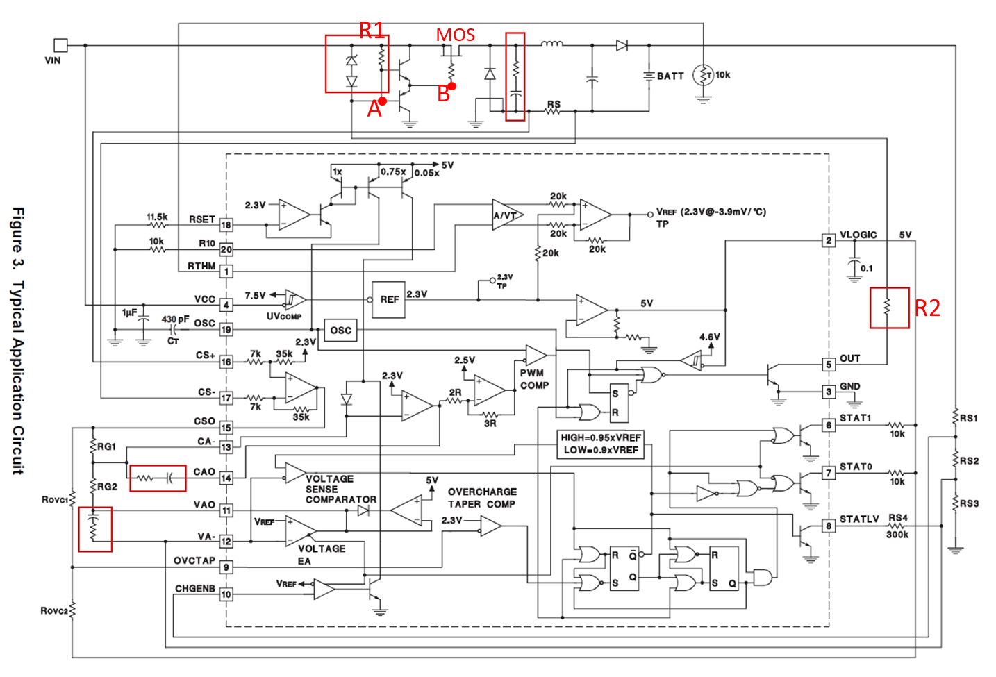

My customer is developing UC2909 circuit. And I have some question about below application circuit.
In the power part topology, I think it is a Buck structure. And the MOS should be a PMOS.
When UC2909 OUT pin=0, Point A=Vin*R2/(R1+R2). If Point A>Vin/2, Point B=PointA-0.7V. If Point A<Vin/2, Point B=Point A+0.7. So we need to set a proper R1 and R2 to make the voltage difference between 'Vin' and 'Point B' large enough to switch on the PMOS.
When UCC2909 OUT pin=OC, Point A=Vin, Point B=Vin-0.7V, So PMOS is switched OFF.
I am not sure if my analysis is correct. Could you please help double check on it? Thanks.

  • Hi Wayne,
    Yes, the topology is buck and the mosfet must be a PMOS since there is no bootstrap or charge pump to increase the gate voltage for an NMOS.
    The stacked bipolar transistors are a simple push pull gate driver.  Your analysis is correct but here are other things to consider:
    I(OUT)PEAK = 100mA <= VIN/(R1+R2)
    The size of the resistors gets IBASE for each bipolar and IBASE*Beta is the gate turn on and off voltage.
