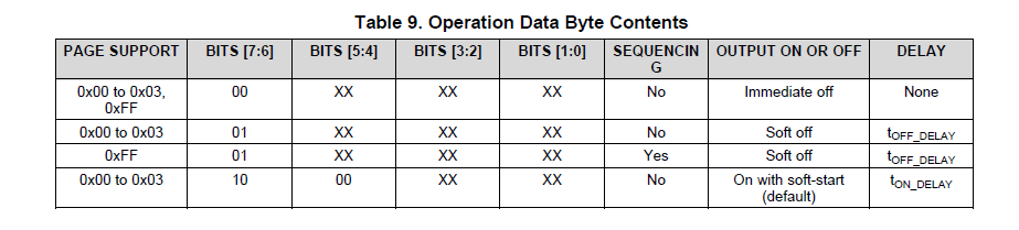

Hi Team,
I have a customer with a question about the TPS65400-Q1:

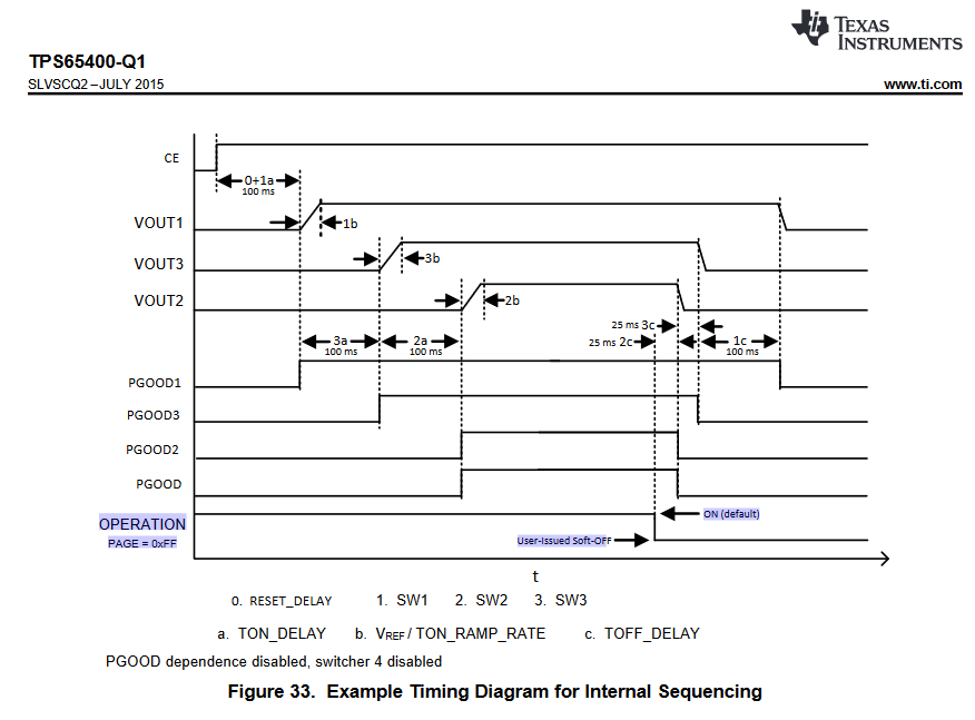

The question is about the soft off function. How exactly do I need to implement the operation? Is it enough to set page to 0xff and writing afterwards 0x40 to the register or do I need to set toff_Delay as well?
Mihir
  • Hi, Mihir
    1. I think "set page to 0xff and writing afterwards 0x40 to the register" is enough to issue soft off.
    2.  You can set toff_Delay according to your requirement, in default, toff_Delay is 0mSec, you can refer the table 34.
