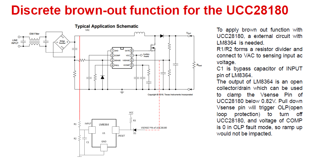

Is it possible to implement UVP of AC in UCC28180?
Are there any PFC products capable of UVP of AC?
