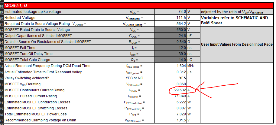

In Rev B of the Design Calculator for UCC28742 (found on this page: http://www.ti.com/product/UCC28742/toolssoftware), are the FET current ratings on the 'Calculations' sheet minimums or do those have a margin of safety applied to them? See below for an example for an 85-265VAC input, 24V 6.5A output designed with this calculator.
Thank you,
Carter
