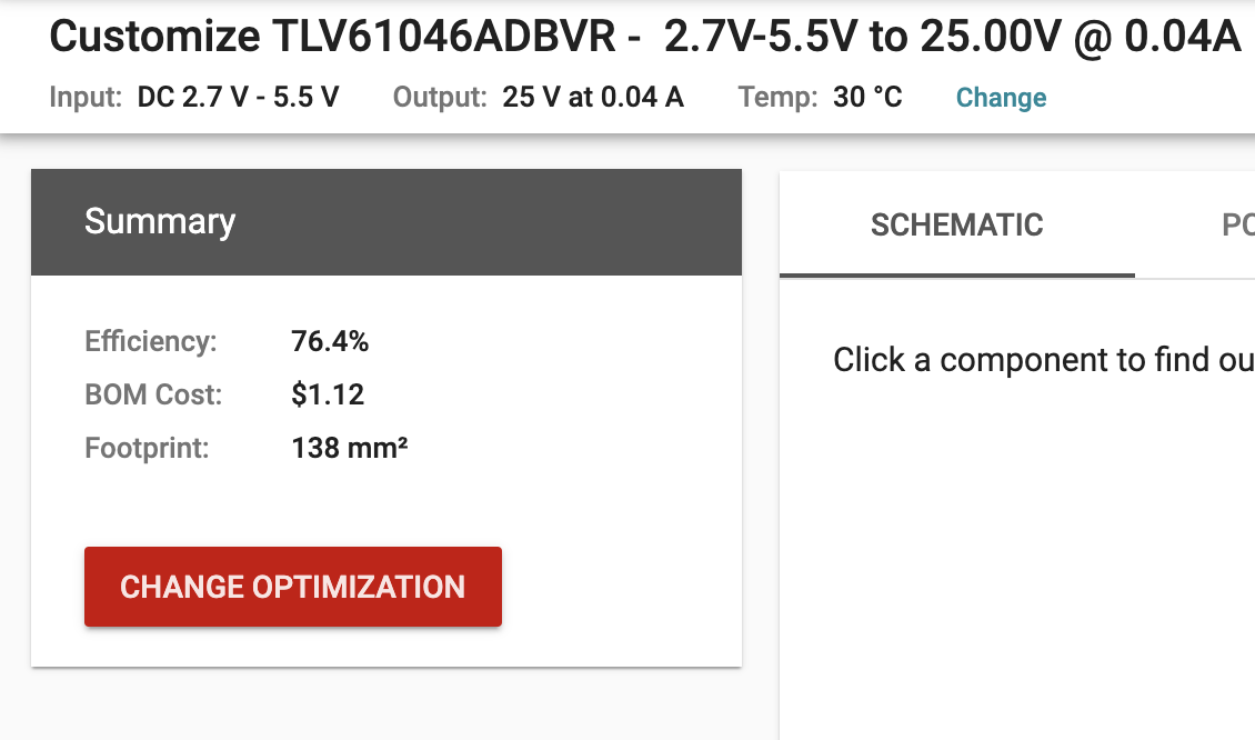

Hi, guys. The input will be
www.adafruit.com/.../1578
Lithium Ion Polymer Battery - 3.7v 500mAh
in order to create 25V (max current 40mA).
3.7V to 25V is quite a big jump. So I was wondering
considering cost / footprint size / safety / efficiency / etc
should I connect multiple boost converters to create 25V?

  • Hi David:
     For the efficiency, TLV61046 reach higher than 80% from 3.6V to 24V with 50mA in our lab. Honest speaking, using multiple boost converter can achieve higher efficiency, but it will cost more size and cost. Also the solution will be more complex.
    For multi-staged boost converter, it's more suitable for higher power, wider voltage application.
    There is a tradeoff.
    As your application is 3.7V to 25V/0.04A. The load is not heavy for this product. And considering "cost / footprint size", that's why I think single boost converter is a better choice. If not, please correct me. And may I know what's your concern about single boost converter solution?

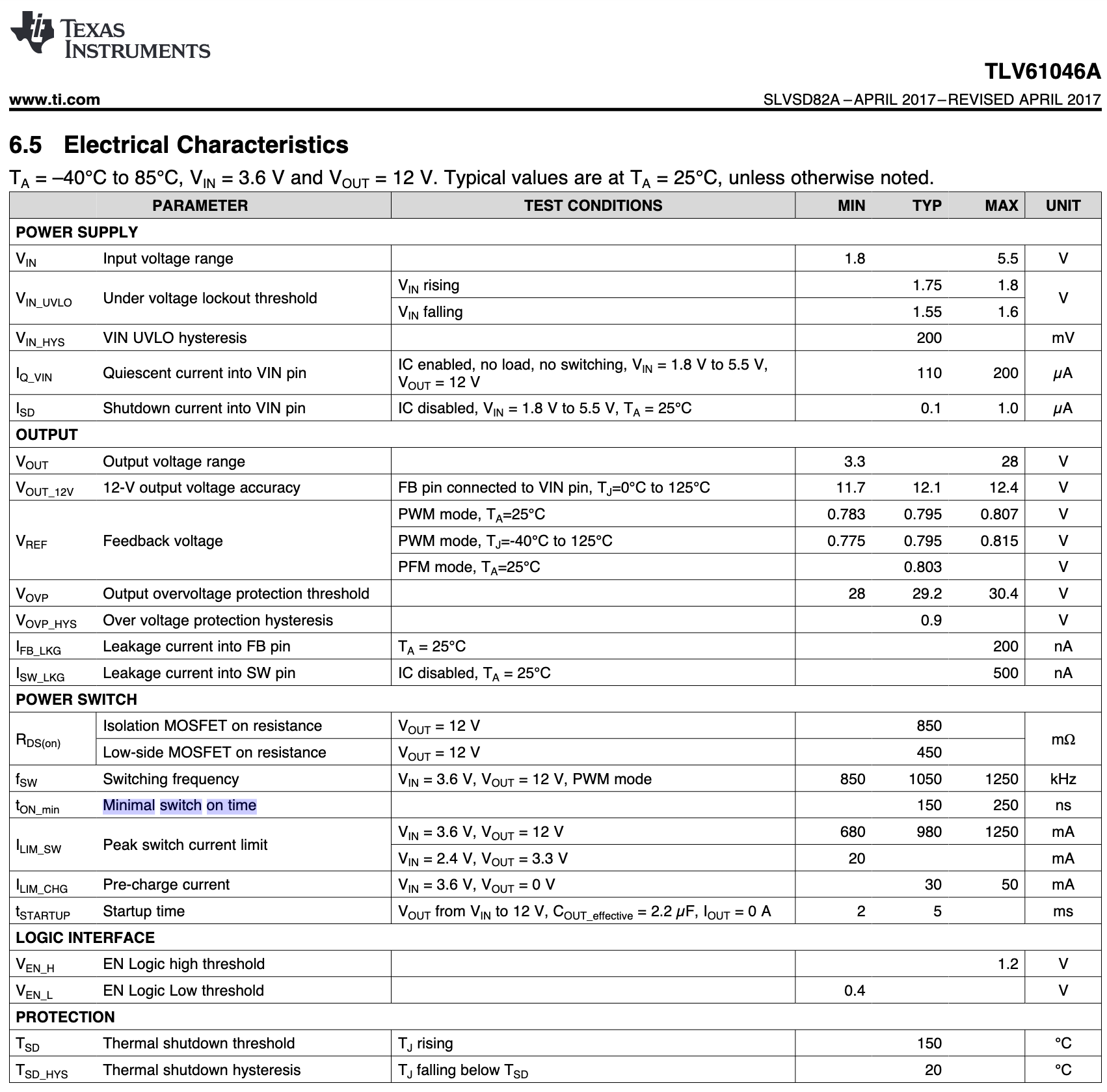

    - When considering a single Boost converter solution, are there other equations or technical issues I should consider?
    - What's the max duty cycle of TLV61046A?

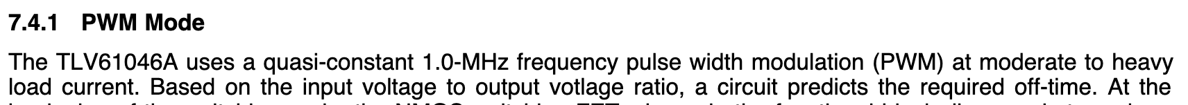

    The TLV61046 is quisi-constant product. And the min-off time is 120ns typically. If the converter calculate the Toff is smaller than the min-Toff, it will used the min-Toff value. And the Ton time will be extended as the current of inductance drops larger as expected. So it will extend the total switch frequency. And finally regulate the Vout to the target value.
    I don't see the Toff part from the datasheet.
    May I ask where you are referring to?
  • Hi David:
    Yes, "Quasi constant". The min-Toff value mentioned is typical value according to dozens parts test in our lab. It's not listed in datasheet.
    And as I said, it won't be a problem as the converter will extend the frequency if it reaches the minimum off time limit.
