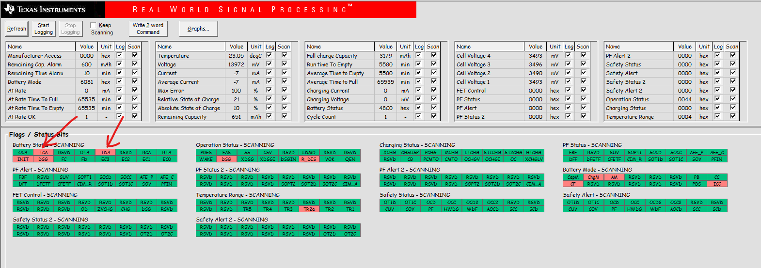

Hi team,
A customer has configured bq20z655 on a BMS board and equipped it with new cells. Unfortunately the two FETs on the BMS are blocking, i.e. Ithez cannot charge or discharge the battery. Thez suspect an error in the flash data, because the flags TCA and TDA are set. I can send you the GG-file of their application for checking it? A 4s2p battery with NCR18650GA cells from Panasonic should be programmed with it.
