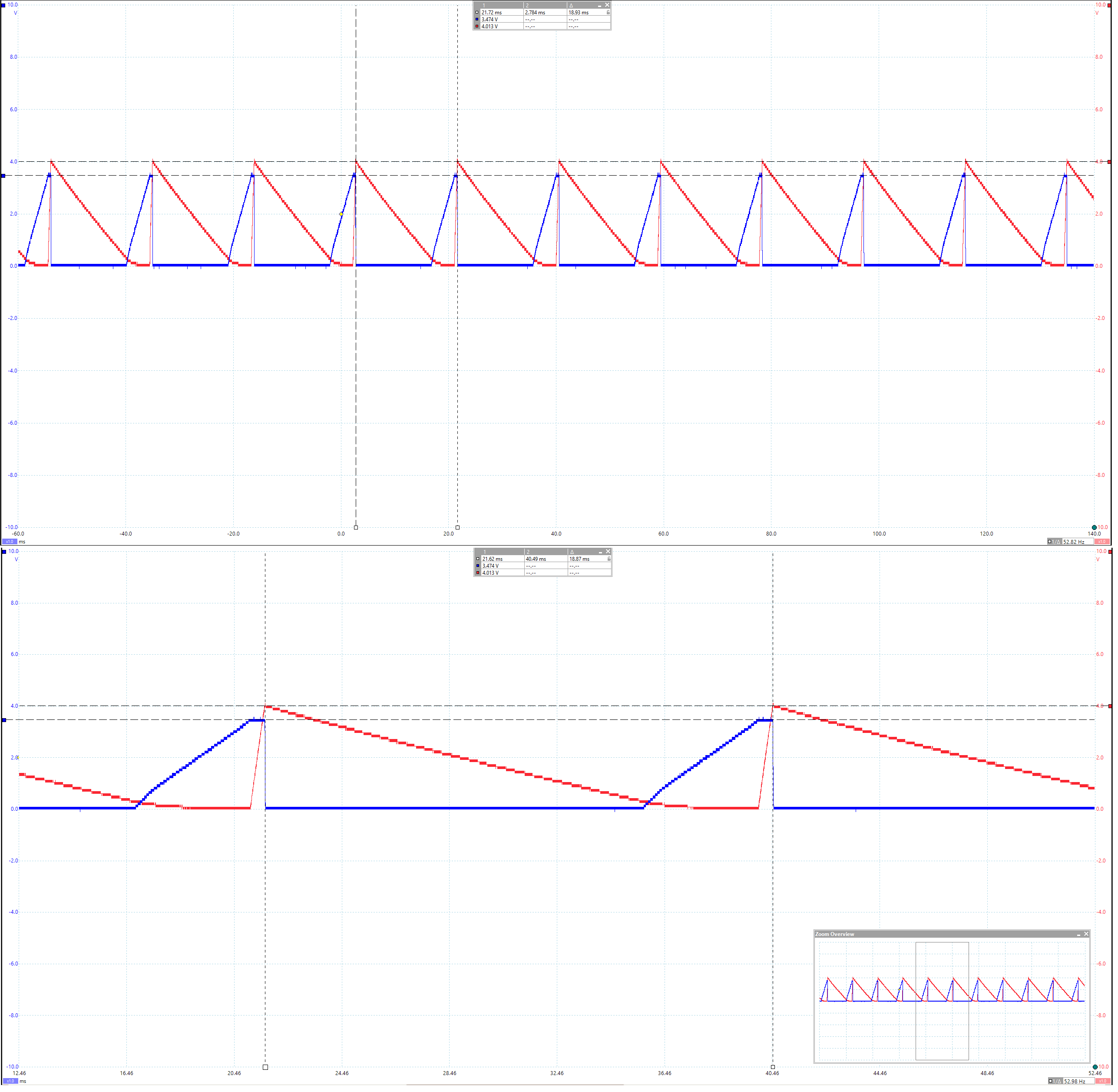

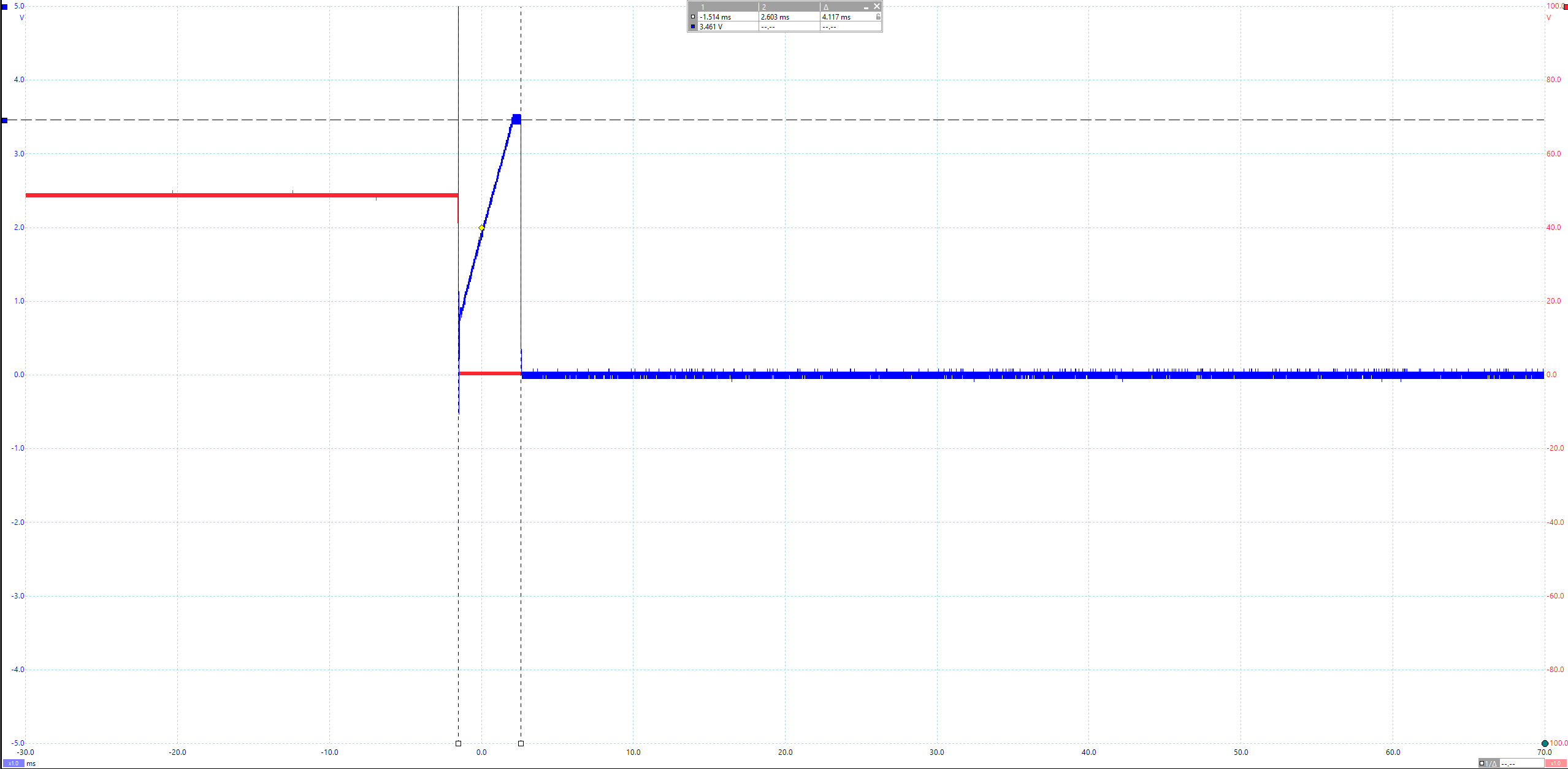

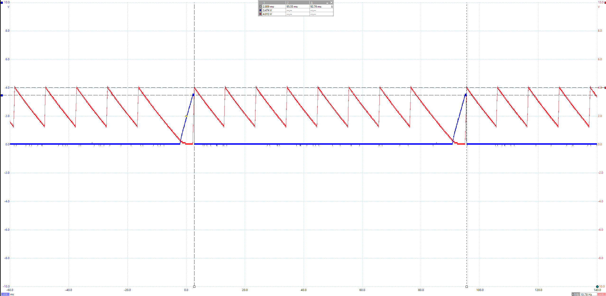

    Just to confirm what you mean: By masking the GATE for any fault event - will this reset the gate repeatedly or only once when masked?
    The reason I ask is because we are experiencing some undocumented behaviour.
    By keeping UVLO tied low and gate masking the fault, the LM5066I repeatedly retries to turn on the mosfet after 1 timer timeout (20ms period on the EVAL board). This leads to what I said earlier - any fault condition is not latched (i.e. OC or OP).
    A completely different set of behaviour is experienced when using the OLVO fault to ensure the mosfet is off at power up, by connecting OVLO to Vcc. In this case, when the OVLO fault is masked, OC and OP faults thereafter are in fact latched and the mosfet is not repeatedly turned on.
    I have attached scope traces showing the gate and timer pin behaviour for both cases during a short circuit.
    Can you explain to me why there is a difference in behaviour between masking UVLO and OVLO, and why when masking the UVLO fault, it repeatedly resets all faults and prevents latching?
    Kind Regards
    Daniel
    UVLO Gate Masked (and tied low), Retries set to 0:
    UVLO Gate Masked (and tied low), Retries set to Infinite:
    OVLO Gate Masked (and tied high), Retries set to 0:

  • Hi Rakesh,
    We are trying to ensure that the mosfet is off at power up.
    To do so we tie UVLO low, then when configuring the LM5066I, the UVLO fault can be gate masked and the rest of the hotswap functionality is as expected.
    But by doing it this way we lose the latching functionality of the OC and OP faults.
    An alternative method is to tie OVLO high and gate mask it. This does not prevent the OC and OP fault from latching and the hotswap controller functions as expected.
    Is this the best way to achieve our requirement of ensuring the mosfet is off at power up?
    Can you recommend another method?
    Kind Regards
    Daniel

  • Hi Daniel, John,
    Thanks for your patience. Similar behavior is observed on our side. The logic is getting reset in case of UVLO mask and retry setting to LATCH. So, we suggest to use UVLO mask in retry mode or OVLO mask in case you wish to configure the system in LATCH mode.
    The OVLO pin can pulled to VDD of LM5066i through a resistor to keep the device in default disable mode.
    Best Regards, Rakesh
