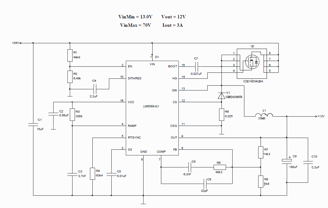

Client using LM5088-Q1 in his power supply project - Vin=13-70V, Vout=12V@3A.
During testing the IC & MOSFET burn down if Vin > 52V is applied. This happens with no load and 1A load.
What might be the cause? Could this be an issue with PCB layout or component selection?
Scheme is attached.
