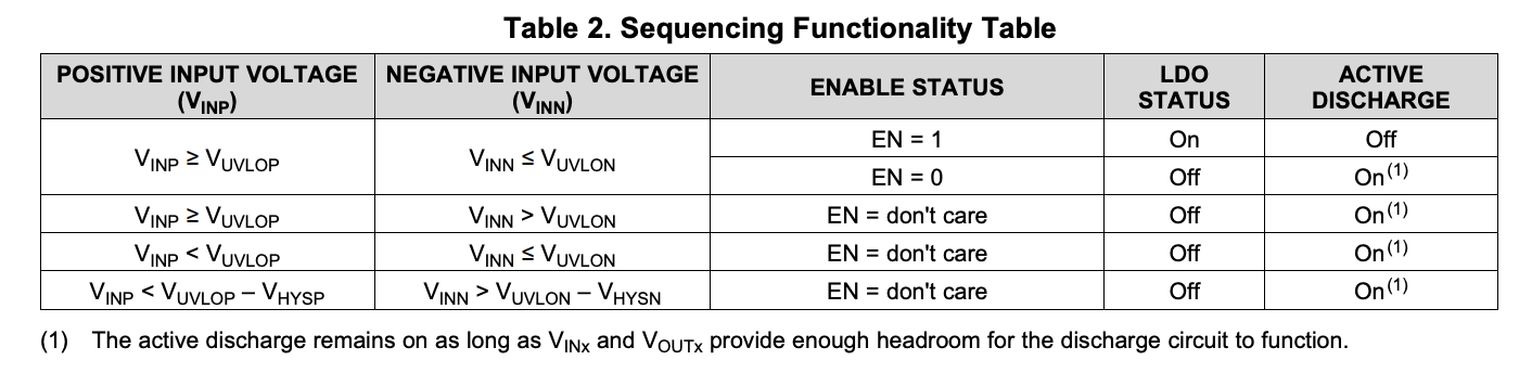

On page 22 of the data sheet SBVS263A are the following in Table 2.
VINP < VUVLOP – VHYSP  and VINN > VUVLON – VHYSN
I do not find a definition or spec for VHYSP and VHYSP anywhere. In the datasheet
or by using a search engine.
What are the values for those two items?

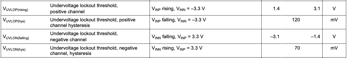

    In the electrical characteristics table we have the following:
    and then the table you refer to on page 22:
    So VHSP should have been labeled VUVLOP(hys) and VYSN should have been labeled VUVLON(hys).
