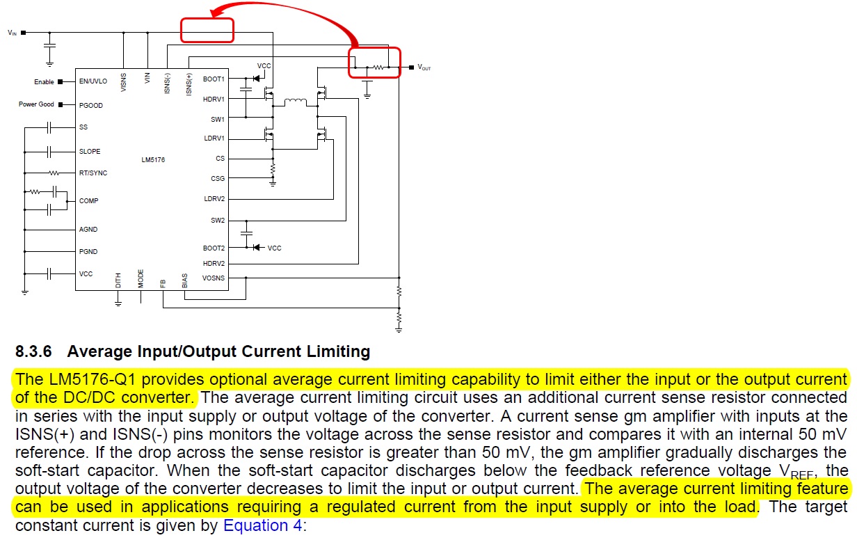

I will design a battery charging circuit with the LM5176.
I want to charge 3A CC-mode, is it possible?
If Hiccup or Average Current Limit is off, the current will flow over 3A without limitation.
And if I turn on the two functions, I think that the current will rise and the charging will end at 3A.
In general, the battery will be charged by CC-CV, so the cut-off time will be very short.
I cannot use Chager IC because I have to use AEC-Q100 certified product.
As far as I know, BQ24616 etc. do not have AEC-Q100.
Is there a way to charge 3A CC-mode?
Vin: 10 ~ 16V, Vout: 14.6V / 3A, and there is an immutable fuse in the Vin line, so you must limit the current.

    The LM5176 can be configured to output a constant current using the average current limiting feature. Placing a resistor between the ISNS+ and ISNS- pin will limit the current when the voltage drop across the resistor is 50mV.

    It is possible to add multiple resistors in parallel to set a static current limit for the average output current. 17mOhm will set the typical output current to 3A

  • 3.3A CC-Mode operation was confirmed by applying a 15mΩ resistor.
    All thanks to you.
    Can the input current be maintained at 3A by changing the 15mΩ resistor position to Input?
  • BAKE KI,
    Yes moving the resistor to the input voltage rail will be used to limit the input current.
