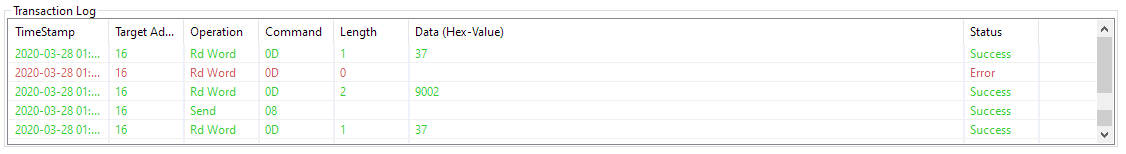

I find a strange behavior during testing.
From BQ Studio, I send the command Shutdown. After some time, the device goes in shutdown and I have no comm.
If I put the charger voltage to wake up the BQ40Z50, it wakes up and I can resume communication with BQ Sutdio.

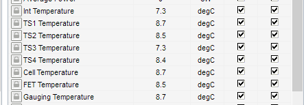

However, if I do the exact same thing, same device, but the temperature is in the range of 7 to 9° Celsius to BMON goes in ROM mode at wake-up !!

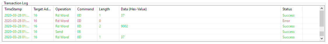

If i send command 0x08 (exit ROM mode), after all is working fine. Configuration is there and all is working as it should.
To be more precise, I use BQ40Z50R2, FW 2.11. I was able to have the issues with the only changes made to config :
1. 3 cells to 4 cells confg / 2. Rsense from 1mR to 3mR / 3. Charger present voltage from 3000mV to 12000mV
Except this, this is the stock/default config.
Can someone help me to understand what is going on ? Thanks !
Below some temperatures, commands (including to one that answer 9002 - ROM Mode) and the config
bq40z50_R2.11_4cells.gg.csv

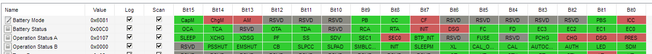

  •  Hi Emilien!
    Could you show OpStatus flags from bqStudio registers window just after exit from Boot loader?
    Is it just single issue or you are observing the same on different bq40z50r2 gauges?
  • Hi Igor,
    Thanks for your fast reply !
    No it's not a single board issue, we can reproduce this issue on any device. I already tested five, and other tests were done on more than 10 total.
    Yes here is the capture of the registers, a refresh just after exiting the ROM mode :
    What do you think ?

  •  SREC image and bqStudio OpStatus register have confirmed my assumptions, your particular device has never been sealed.
     Never-sealed device has some special undoc features in respect to BootROM entry methods so you probably observing the edge case of it.
     It's only my assumption, try to Seal device and check if issue still happens.
     Thanks.

    Igor, for sure this device was never sealed, you should have ask  ;)
    But... what you say is perfectly working ! How this can have such a behavior ???
    I have no problem at all if the device is sealed !!
    Many thanks for your great help !!
    But this blows my mind... this is out of my understanding to have such behaviors. Can someone explain me a technical reason to this ? What I missed in the documentation ?
