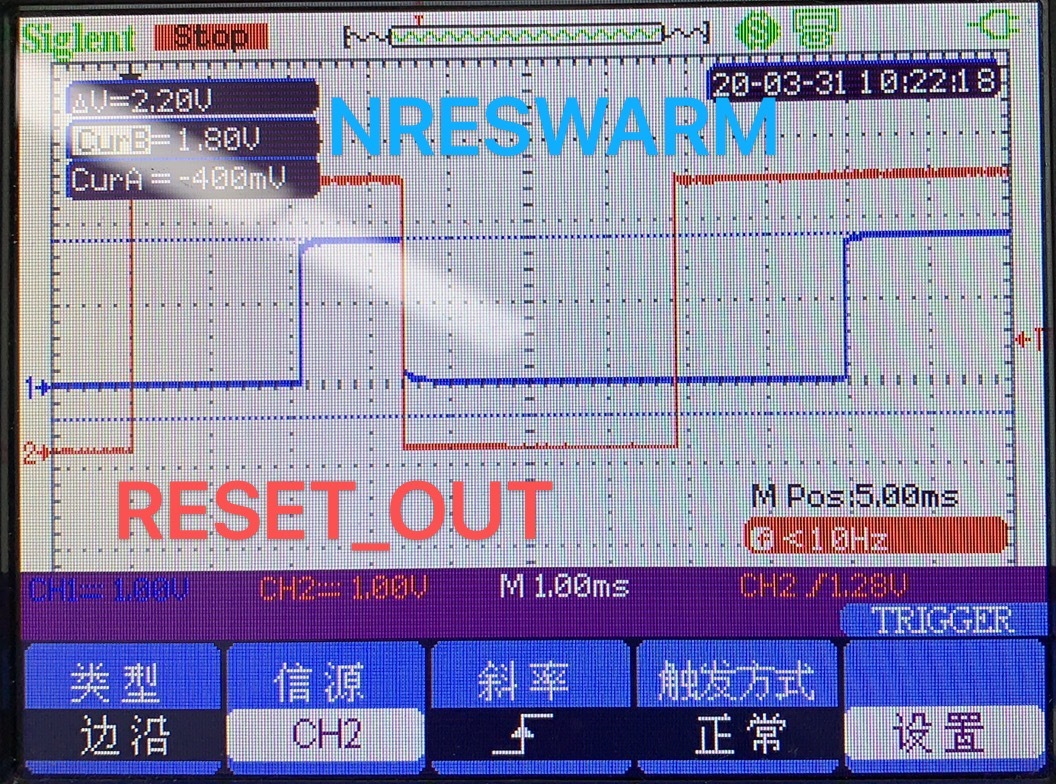

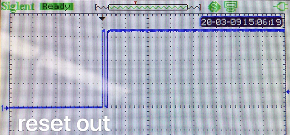

In our project,we found RESET_OUT pin has twice reset,as shown in the following figure. Please help to confirm whether this waveform is correct?and why the pin “RESET_OUT” has twice reset?
Thank you!
    Welcome to E2E! I cannot tell the time scale from this image, but this toggle could happen if you are doing a warm reset. Do you know if the NRESWARM pin was initiating a warm reset to the system?
    If this is the case, the RESET_OUT is set to complete a toggle during the warm reset to satisfy an errata listed for the Jacinto 6 processors. In the Jacinto 6 errata documentation, the processor requires a toggle on PORz to ensure that it doesn't get stuck (i862 in the errata documentation).
    Let me know if this warm reset may be what you are observing.
    Nastasha

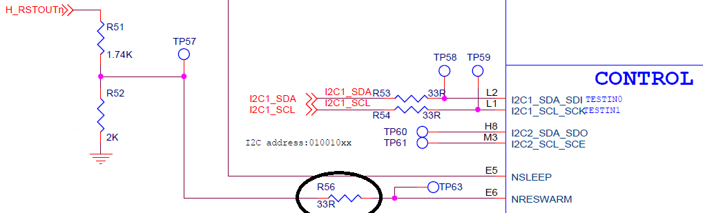

    The waveform is as follows.(RED is RESET_OUT,BLUE is NRESWARM)
    And I disconnect the R56,RESET_OUT is the same as before.

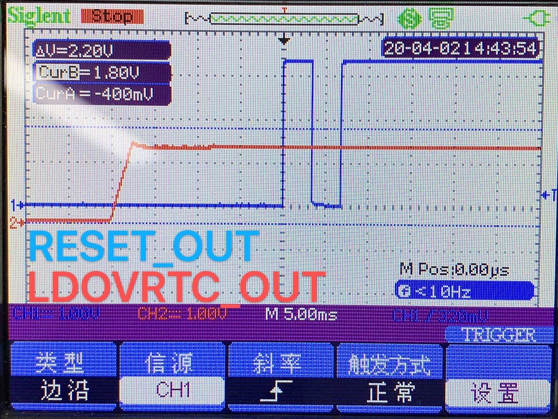

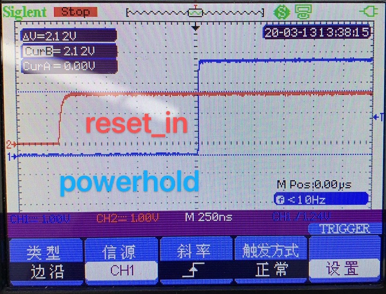

    Can you also try measuring LDOVRTC, POWERHOLD (GPIO_7), and RESET_IN?
    Also, do you know if the output rails (SMPS and LDOs) are staying high during this time?

  • Hi:
    And the output rails (SMPS and LDOs) are staying high during this time.

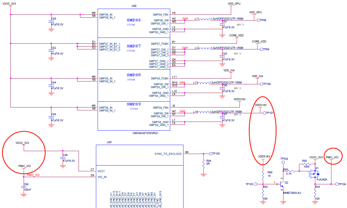

    Does this only happen at startup? If so, how is VIO_IN powered? It looks like this toggle may be occurring while the OTP settings are loading. To prevent this, VIO_IN should be supplied after VCC1.
    Nastasha
  • Hi:
    Yes,this happens only at startup. In our application,VIO_IN is supplied after VCC1 as you say.  VIO_IN is enabled by SMPS9.

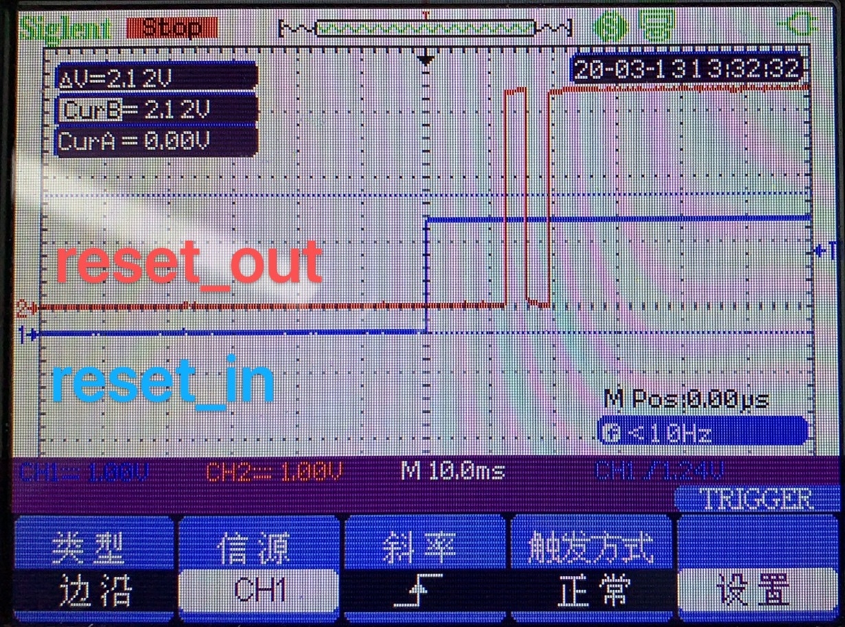

    Okay, thanks this looks okay. Hmm, can you also verify POWERHOLD (GPIO_7) remains high during the RESET_OUT toggle? The scope shot you have of POWERHOLD with RESET_IN is too zoomed in to see whether it toggles at the point RESET_OUT does. Also, is PWRON doing anything during the RESET_OUT toggle, or only remains high?

  • Hi:
    Yes,POWERHOLD (GPIO_7) remains high during the RESET_OUT toggle.PWRON is float with nothing connection.
