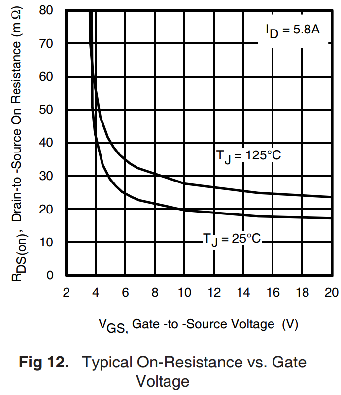

    1. I attach the circuit to the board with BK34Z950. The sensor resistor is 0.01 ohms. FETs irfml8244. Voltage on the gate of the charging fet is 11.8V, voltage on the gate of the discharge fet is 18.5V.. Judging by the graph (screenshot in the attachment), the drain-source resistance is less than 20 mOhm.

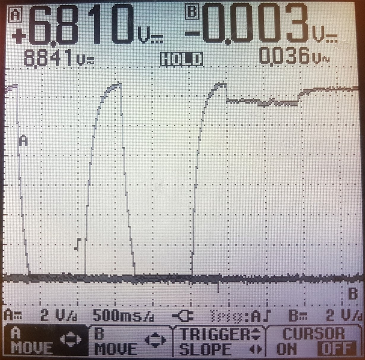

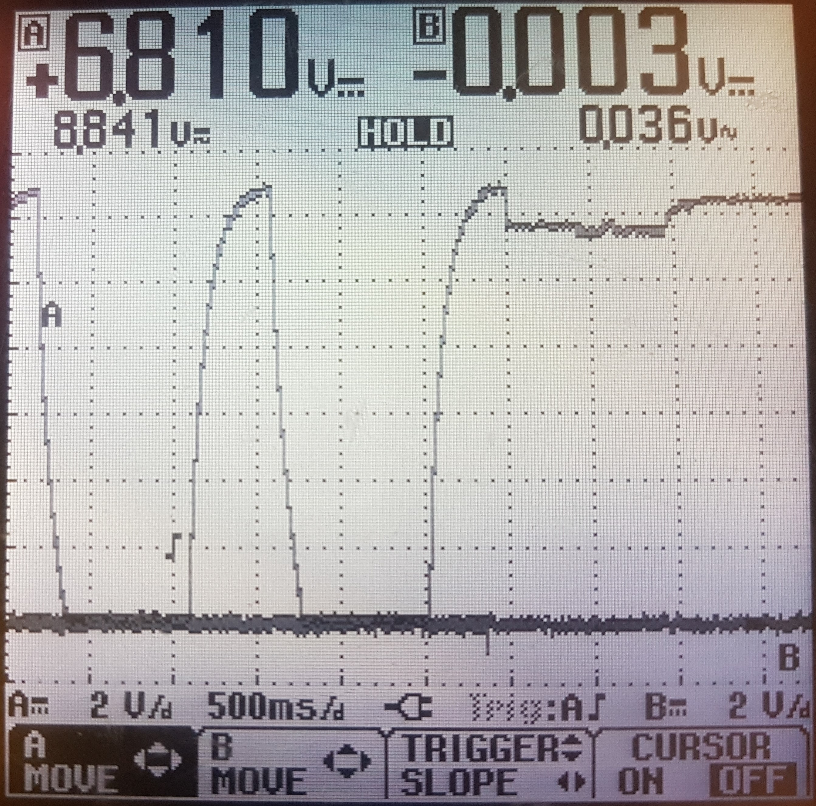

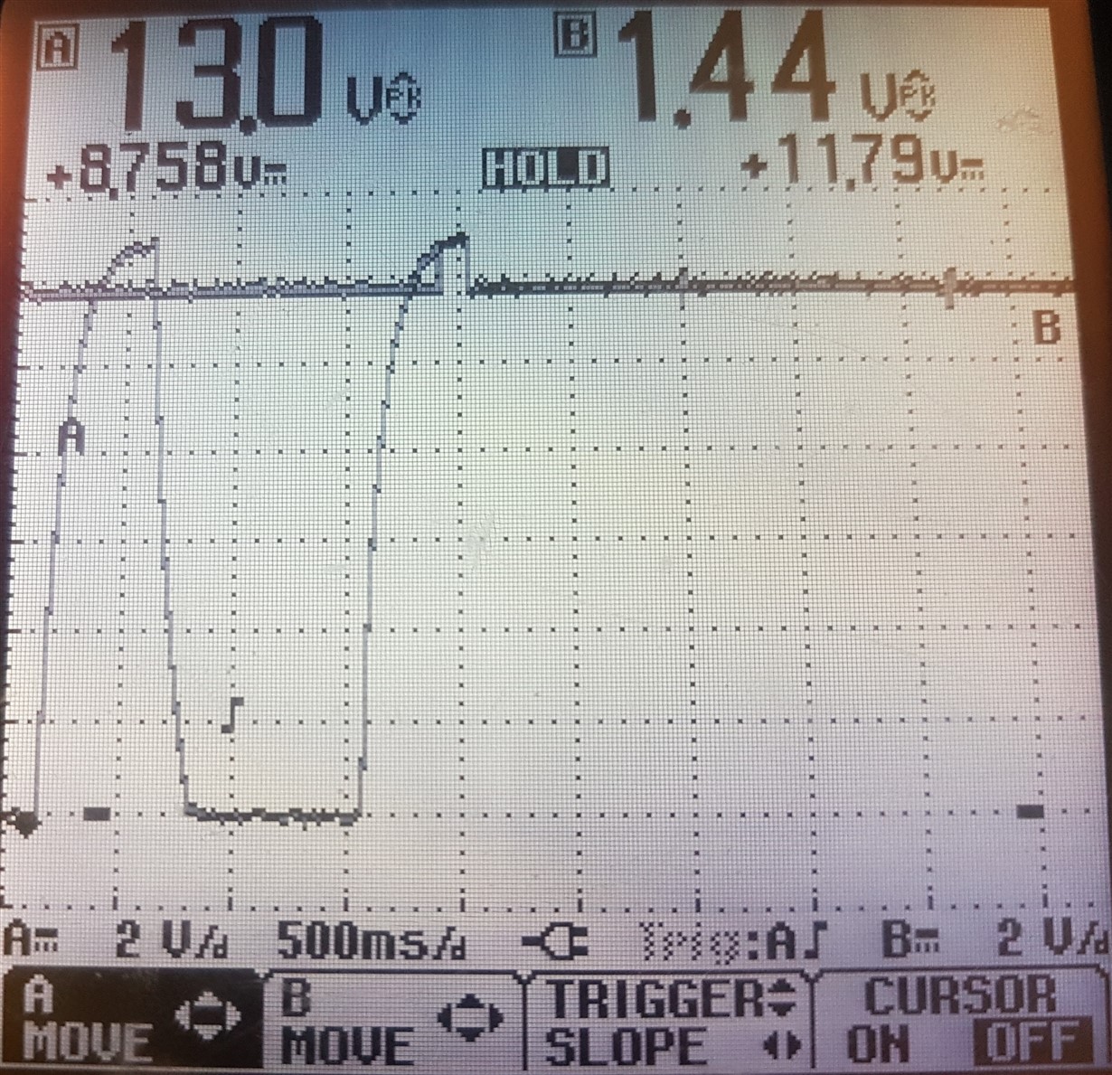

  • Hi, Jeff!
    I tried to take scope shot with an oscilloscope.
    Channel A - charger, B - battery. After connecting the battery, a straight line with small pokes.
    Channel A - charger out. Channel B not connected. I managed to connect a couple of times this way - the voltage rises a bit, stat 1 lights up, but the battery LEDs do not indicate charging.
    I tried to capture Ibatt, but failed. Connected directly to the battery sense resistor to measure the voltage drop. With an oscilloscope, I simply could not achieve the results that I understood, and when measuring the voltage drop with a multimeter, I got 0V

  • Nikita,
    As I mentioned previously, this a V=IR issue. If you cannot reduce the R from battery to charger or the Iterm enough to prevent a droop before the recharge threshold, then you will either have to accept the STAT pulsing as the charger enters and exits termination or disable charger controlled termination.
    Jeff
