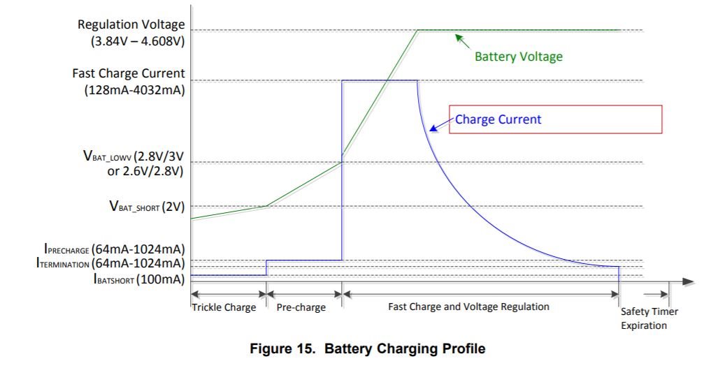

hello,
Please tell me about Table 6.Charging Current Setting in the datasheet.
When VBAT is 2V to 3V, IPRECHG=0mA(DEFAULT).
If VBAT is 2V-3V when running in Default Mode, does it not charge permanently?
Will the 4-hour Safety Timer expire and end the charge?
