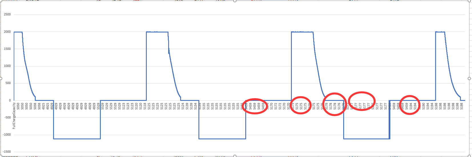

   BQ27542-G1 low temperature learning GG file is jump in room temperature, RSOC is 100% in charge mode, reduce to 97% in relax mode and ROSC from 97% to 100% in charge.
The low temperature GG file we got was corrected at room temperature GG from GPC. Whether the low temperature GG only learning at low temperature?
