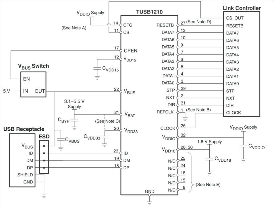

Hi team,
Is TPS2553 suitable to be VBUS switch for the function of USB2.0 OTG of TUSB1210 ?
Or is there a better solution?
Thank you.
Hi Cindy,
If only data OTG, that's fine to use the power switch.
If power also needs flow in both direction, maybe have some concern.
For power flow both direction, refer to following case:
http://e2e.ti.com/support/processors/f/791/t/358092?USB-OTG-operation-on-AM335x
