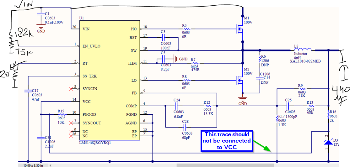

Hi TI,
i am using a Buck converter using LM546-Q1 .I have design for 8 amp out, for 13.5V
Input 30-60V input .
i am using RDSon for current limit sense . But in the datasheet it is not clear how ILIM pin save the circut for overcurrent protection please explain.
. The issue i am facing with surge current.it is working fine while i am incresing the current from 0-1-2-3---8 up to 8 amp but while i am suddenly add load the circut went to hiccup mode as like short circuit.
Please let me know how to resolve the issue,
Is the anyway i can limit the current for 10 amp max?
if i will use ILIM pin for 10amp limit the current, curcuit not able to take surge current. Please provide some suggestion .
