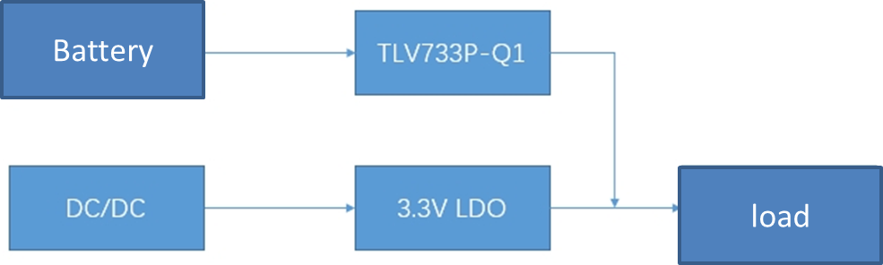

My customer now evaluate TLV733-Q1 and found that it has quickly discharge function, which include an active pulldown circuit.
But my customer doesn't want this function and do we have another version without quickly charge?
Thanks!

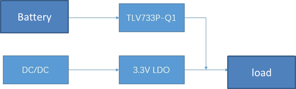

What customer concerned is if they don't use battery, even though TLV733P disable, the output of TLV733P still has 3.3V/120ohm leakage current because of the quickly discharge function... Do we have advice to avoid this?
