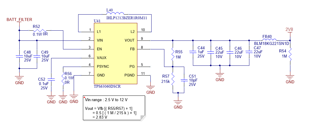

I would like to know the TPS63060DSCR, regulator’s noise and ripple specifications. I couldn't find this information in the datasheet. Please let me know.

If I understood correctly, you are interested in output voltage ripple, and PSRR performance of the TPS63060. Could you please give us the specific operating conditions (Vin, Vout, Iout), and we will look into the data?

In the meantime, could you please tell us why did you choose the TPS63060? This device is suitable for higher input/output voltages. For the above conditions (Li-ion input, Vout = 2.8 V), we would recommend another device, for example the TPS63030,

Thanks for your suggestion. I chose this part as a common design for existing products. If TPS63030 can provide better noise performance, I will consider changing it. If you can provide some performance data for TPS63030 using our requirements, that would be nice as well. Thanks.

Please find attached the PSRR and ripple measurements for the TPS63060 and TPS63030.
