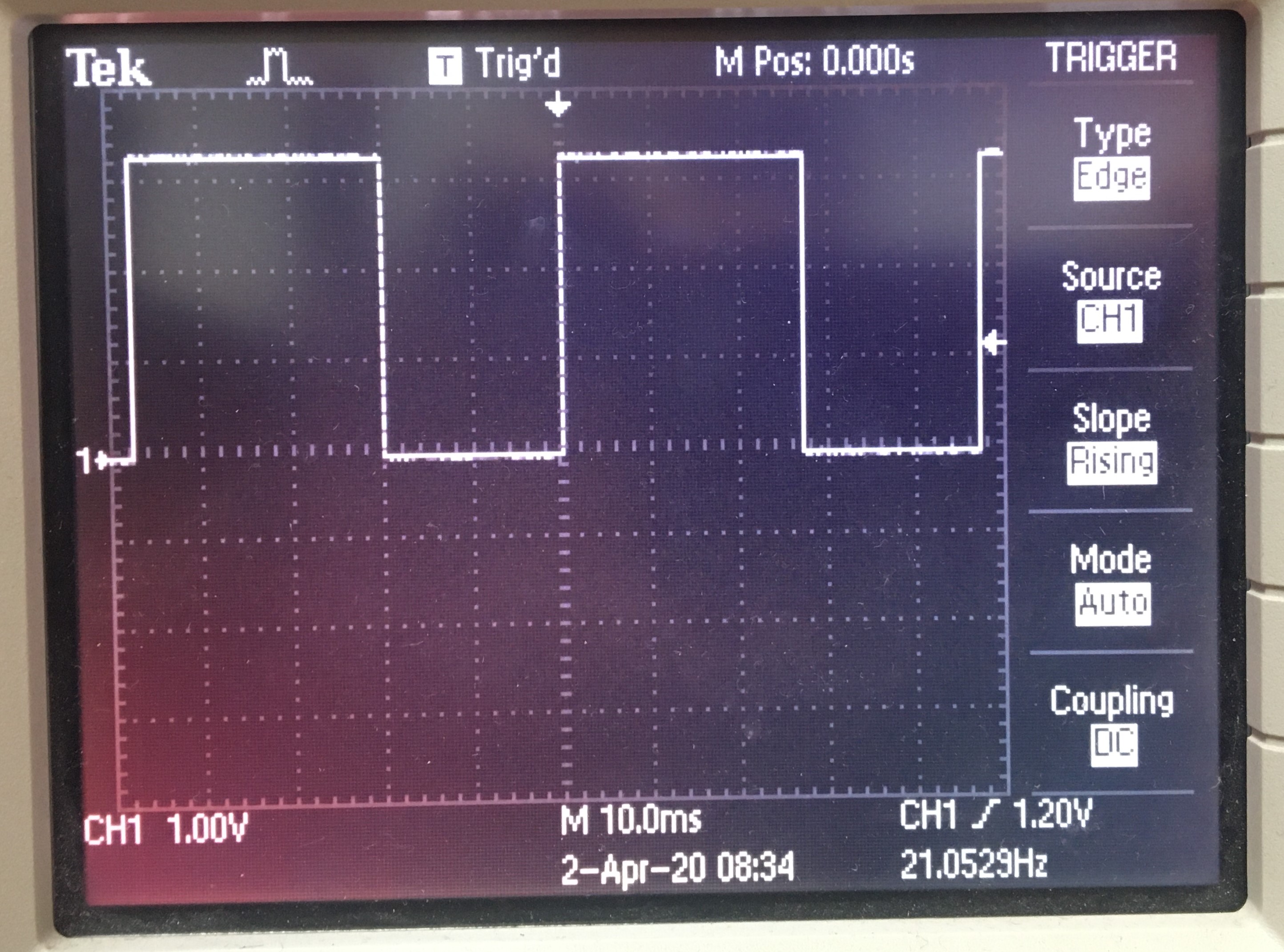

I've implemented Q&A watchdog between TPS65381A-Q and RM42Lx Launchpad, I'm running WD diagnostics as describe in the Hitex example and it all works as excepted.
When I'm setting the RM to initialize the WD without the diagnostic part it runs perfect, when I run the same code after the diagnostic state and sending the TPS with TPS_ExitDiagnosticMode(); I lose syncronization and the watchdog fail count is always 0x07, the TPS state is Safe (0x04), and the watchdog status register is 0xC0.
Please help

  • Hi Yuval,
    Have you been able to confirm that the RM43L432 keeps sending the answers to arrive in the expected window1 and window2 configuration after exiting the DiagnosticMode? If you have access to the SPI pins the best option would be to probe the lines to make sure the Q&A sequence timing is preserve.
    Ivan
  • Hi Ivan,
    I don't have the right tool to capture the SPI, but I did toggle a GPIO on rti even see pic attached:
    WD init is:

    When I'm running the code with out the diagnostic stage everything is fine see printout of registers below:

    problem starts when i run wd diagnostics-->initializing WD-->exit TPS diagnostic mode: On the scope I see the exact same image as above, but the registers shows:

  • Hi Ivan,
    I noticed that the TPS WD_WIN1_CFG Register and WD_WIN2_CFG Register are getting corrupted: after diagnostics:

  • Found the problem, I was calling TPS_ConfigureWatchdogReset() by mistake, all working now.
