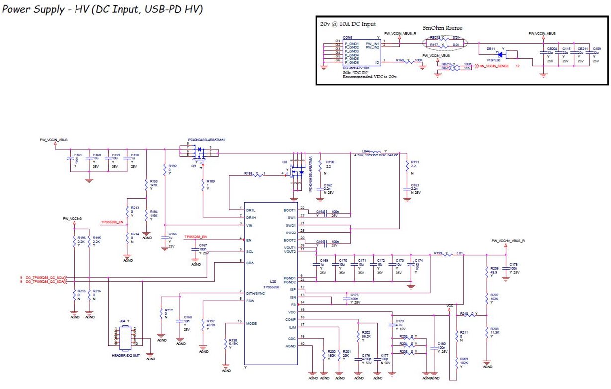

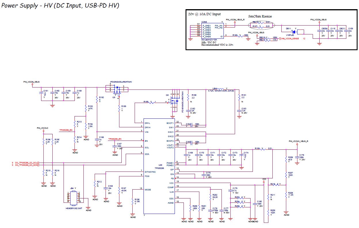

Hi team,
Could you please help check the schematic as below and let us know any needs to adjust/modify?
Also, there are some questions in below about the EVM user guide.
1. Does ground have to separate AGND and GND?
2. All the headers can be removed?
3. On page 7~9 in the user guide, what R and C can be changed to 0201 size?
4. On page 7, NT1~NT3 can be removed?
5. On page 7, What's C1 capacitor value range? Or that must to have 68uF? The cap can be changed to SMD cap?
Thank you!TPS55288.pdf
