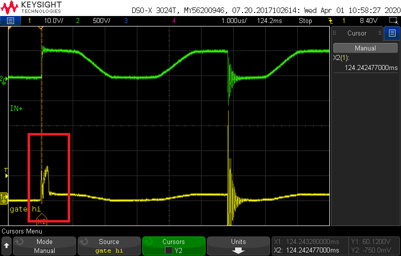

Hi.
Gate signal falls apart immidiately after it reaches 12 V and stays down until the next cycle comes. Slew rate is in range. Boot cap and Vcc are stable. This happens in both continuous control range and burst mode.
Ehsan
  • P.S. the green line is the voltage in middle point i.e. HS.
  • Ehsan
    First off I we recommend that you use UCC256402 instead of UCC256302.  UCC256402 is a pin-to-pin compatible improved version of this device.  Details are in this app note http://www.ti.com/lit/an/slua966a/slua966a.pdf
    It appears that the gate drive is only high for about 250ns, which is the minimum gate on time.  We need more information on your design in order to help here.  Can you please provide the following information?

  • Hi Eric,
    Thanks for your fast response. I have already checked the Excel tool in design phase of the project.
    - The schematic is unfortunately confidential and cannot be published. I can give you all the info you need though.
    - Input range is 505 - 600 V and the output is regulated on 15 V and 50 W.
    - Operating condition is 550 V and 5 W. Switching frequency seems to be set at about 95 kHz.
    (- Capacitors on VCR Pin are C_upper = 470 pF and C_lower = 1.5 nF. )
    Could it be, that the adaptive dead time is too high?
    I would appreciate it, if you'd highlight some of the reasons, which come to your mind.

    If I understand correctly, this issue is occurring at light load. One potential issue that may be occurring here is that the slew rate on the switch node can reduce too far where UCC256302 can no longer detect it.  The minimum slew rate that UCC256302 can detect is 1.0V/ns.  If this is causing the issue, switching over to UCC256402 will solve your problem since it has a minimum detectable slew rate of 0.1V/ns, which is 10x smaller.

  • Hi Eric,
    The slew rate falls perfectly within the specified range and modifying it didn't help much. Although, I reduced the lower resistor in the feedback voltage-divider and the problem is solved! Do you have an idea why? There doesn't seem to be a connection between the two! BTW, the problem was in all loading conditions there and not only in light loads.
    Ehsan
  • Ehsan
    I'm not sure which "feedback resistor" you are referring to.  Is it the same as R19, R23 in UCC25640EVM-020?
    If this resistor divider network is different than what you expect, the LLC converter can be operating at a point that is different than originally designed.  Operating at this higher voltage point could have caused several different things that could have caused the misbehavior you were seeing, from a fault condition being triggered or the power stage unable to have sufficient gain to work at the value the actual resistor divider network was set at.

  • Hi Eric,
    Yes these are the resistors. I adjusted them very slightly though.
