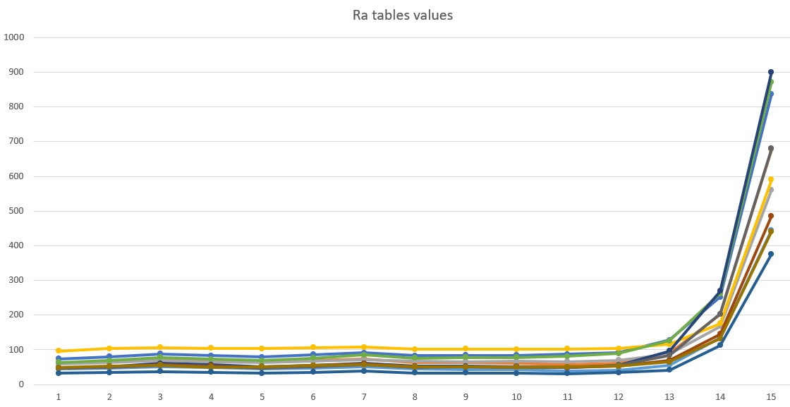

  • Hi Damian,
    Since these values are learned and updated in the field I am wondering whether the learning cycle is really necessary.
    Actually I do have access to the real capacity (Qmax) of my batteries, and I notice that across different number of series cell and capacities the Ra tables are pretty similar (see below)
    Would it be possible in that context (same battery manufacturer, same cell model) to "build" a golden image by setting the Ra table, Ra flag and Qmax in the gg.csv file without performing a learning cycle?
    Jérémie
  • Jeremie,
    I would recommend doing a learning cycle one of the cell first then you can fan it out appropriately to other cell configurations. The reason for this even though learning is done in the field it's filtered/limited. The resistance isn't allowed to change more that 15% per discharge cycle whereas learning cycle is unfiltered and without the restrictions.
  • Hi Damian,
    Indeed, I see that the design resistance varies depending on the capacity of my battery pack (i.e. number of parallel cells). Is the learning cycle still necessary if we guess this value from previous measurements? i.e. is there anything else that the learning cycle compute?
    Jérémie
  • Jeremie,
    Typically as capacity increases resistance decreases. For the same cells as you increase the number of parallel cells the resistance decreases. If you know the resistance (Ra values) for one cell and Qmax from a learning cycle you can scale appropriately for different battery series and parallel cells configurations.  As mentioned before Resistance and Qmax are what's learnt from the learning cycle.
