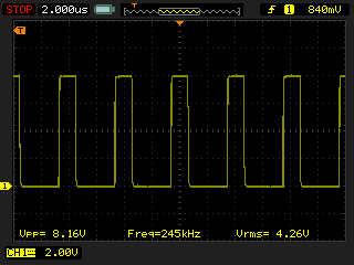

    Can you give scope shots (a few cycles) of the COMP, SW, and SS, and DIS pin?
    Richard

    RC pin looks to be fine, around 240kHz switching frequency, as planned originally:

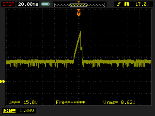

    ISNS (Current Sense) pin shows some interesting behavior, peaks at about two seconds, like overcurrent, although there is not much output current (and capacitance).

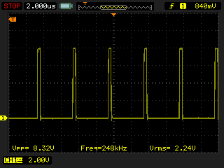

    Power MOSFET Gate has a similar power up/down pattern. It is starting in every ~2s with somewhat different duty cycle:

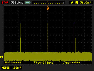

    On HV_POS output of the regulator seems to be a bit crazy with some unexpected peaks:
