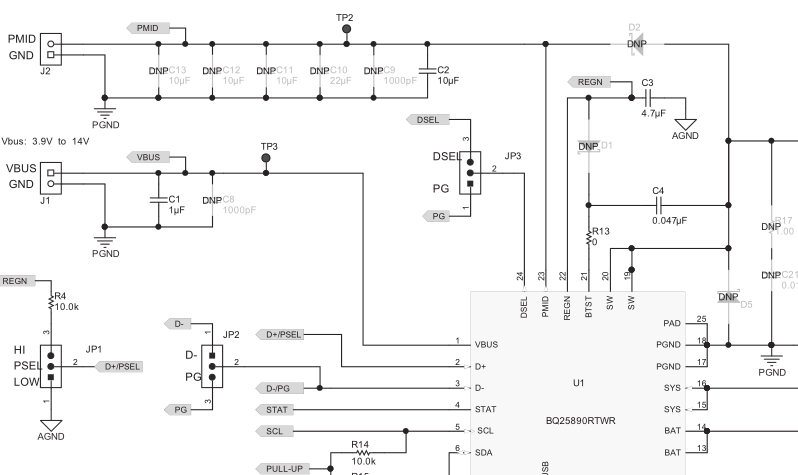

  • I do not have a diode from SW to PMID.  Looking at the evm schematic, it shows D2 as "DNP."
    I have 44 uF on PMID ( 2 x 22uF).  The evm schematic shows potential for 6 10uF, but 5 are marked "DNP."
    I can easily add another 22uF, and I'll see if I have an appropriate diode lying around.
  • Paul,
    This schematic above is for the BQ25890 not the BQ25895.  The 895 schematic is further down in the user's guide.
    Jeff
  • I'm an idiot!  Sorry, I did not see there were multiple schematics in this doc.
  • I added a diode and another 22uF cap, and so far so good!  I'm not sure what I will do about the high voltage charge issue as my device will surely be destroyed if PMID exceeds 5V.  However, this will get me through the demo!
