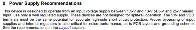

The following contents are described in the data sheet.
1. If the customer follows this statement, the recommended operating input range is 4.5V to 18V (VIN=VDD).
 Is this understanding right?
2. Please tell me why the specifications of VIN and VDD are described separately.
 Customers don't understand why VIN and VDD have different specifications even though TPS548A20 don't support split rail.
