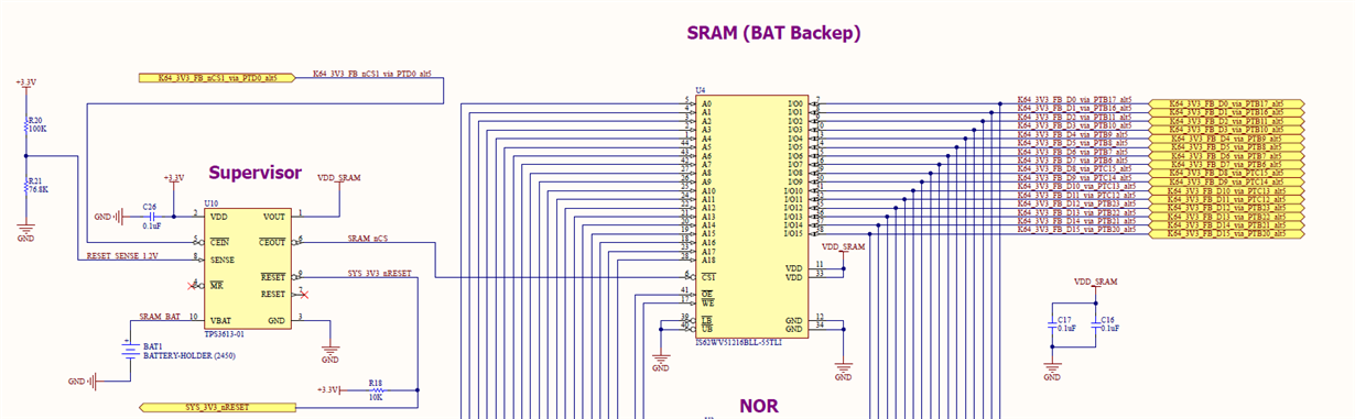

We currently use the TPS3613-01 to manage battery backup for the SRAM (SRAM part number: IS62WV51216BLL-55TLI) on our PCB. We are trying to determine the battery life of the coincell battery if our product is powered off (unplugged).
The coincell we are using is a CR2450 with a typical capacity of 620 mAh.
Our electronics technician measured a current draw of 54.5uA on the battery. This number is higher than expected and we are trying to determine why. The only thing directly connected to the battery is the TPS3613-01, and then the SRAM is connected to VOUT on the TPS3613-01.
I've looked at the datasheet for the TPS3613-01, but it is not clear to me how much current the device should draw from the battery. Once we know what the TPS3613-01 should be drawing, that might help us narrow down our problem.
Here is a relevant snippet from our schematic:
  • Hi Andrew,
    The device itself has up to 40 uA of supply current, and my guess is that the rest could be going into the resistor divider on the SENSE pin. How much current are you expecting?

  • Hi Andrew,
    The supply current still applies when VBAT is connected to VOUT on the device.The device consumed 40 uA of current itself. Since the power the SRAM can draw can vary, we can only specify what the device uses for supervisory functions.
    Abhinav.
