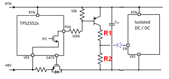

Hi, we've done a design based on the spec (9.2.2.10 Power Good Interface to Downstream DC/DC) to deactivate the downstream brick of the design.
However, we needed to tweak it a bit to get it work because we need to invert the PGb signal.
Here is what my design should have :
Hotswap GOOD
PGb = 0             Brick Enable pin = open
Hotswap NOT OK
PGb = Open      Brick Enable pin = 0
On my design the issue I just found is that the voltage divider at VEE is not working when PGb is floating because VEE became floating also because of the oring-FET!
By comparison with the hotswap spec (9.2.2.10 Power Good Interface to Downstream DC/DC)  , on my design I also have an o-ringFET on the left…which disconnect VEE so the voltage divider is no longer working between RTN and VEE…My FET is then having 48V at his gate which failed the Vgs spec of 20V and burn it I guess…
Does we can use another pin as a references to do that? like Vref or something else?
Or any other idea?
Thanks for your help!
David

  • Hi David,
    Thanks for reaching out!
    The circuit mentioned in Section 9.2.2.10 Power Good Interface to Downstream DC/DC of the datasheet should work even if you use ORing-FET. Have you tried that ?
    Regards, Rakesh
  • Hi Rakesh, I didn't try the circuit in section 9.2.2.10 because on my side  it's preferable that the enable of the brick is floating instead of pullin up.  that way when PGb is floating, I need the transistor to be activated to put a 0 and deactivate the Brick instead of a pulldown, like in my schematic added.
    But by doing that VEE is disconnected to the voltage divider is not working.
    Does any other pin can serve as a reference instead of VEE?  I'm doing some calculation to use exactly like the section 9.2.2.1, but that's tricky as the brick outputs also a voltage on his enable pin when enabled...that's why it's better to make it floating to put it ON.
  • Hi David,
    You can consider using optocoupler as below. When PGb=OPEN, photo-diode conducts to pull down the brick enable pin to LOW. similarly, it eaves the brick enable pin OPEN if PGb=0.
    Best Regards, Rakesh
  • Hi Rakesh, thanks for this update. This way seems similar of what I've done in my schematic
    But on my side I also have an oring FET on the "left" of VEE pin, so when PGb is floating, this FET will also be OFF and we will lost again the references of the photo-diode, like I've done in my schematic...
    If connecting it directly at -48V input, I will lost the oring-fet protection...
    That's seems difficult to find a solution…  Does the gate of the FET can be used as a reference instead? does it keeps it's references to RTN when gates are OFF?
  • Hi David,
    VEE of TPS2352x is the only reference available.
    Regards, Rakesh

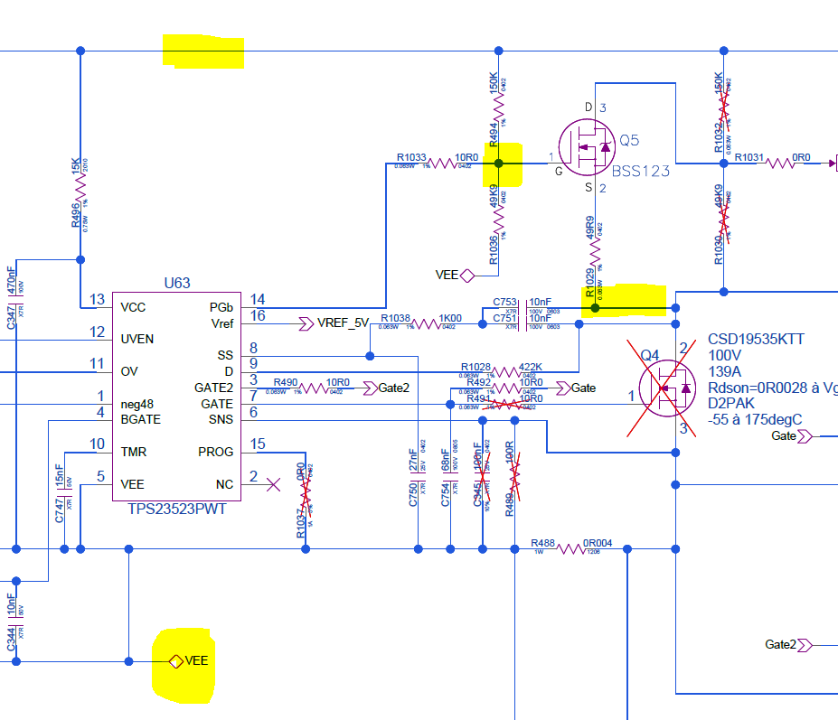

  • Ok, so what are my other options?  I assume that when the oring FET gate and the others FET gates are off, the chip is still alive from RTN and -48V input...so any pin referenced to RTN would work no?
    I wonder now how the OV and UVEN pins are still working when the oring-FET is deactivated thus losing the VEE connection from -Vin48? Does it takes the references from somewhere else inside the chip? (like Neg48?)
    If OV and UVEN are still good, I wonder why my schematic is not working unless there is something different internally?
    Thanks for the clarifications
  • Hi David,
    The system will have reference through the body diode of ORing FET to -48V.
    Regards, Rakesh

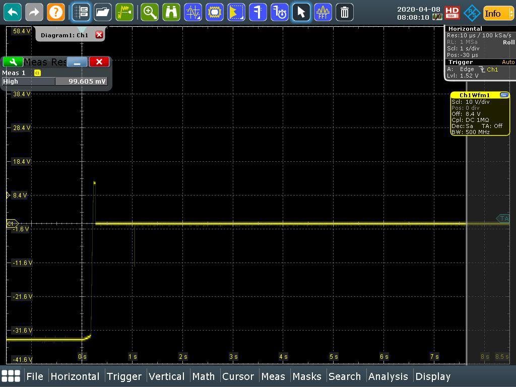

  • Hi David,
    Can you provide test waveforms of the highlighted nodes with respect to VEE during startup. The drain potential of the hot-swap FET varies during turn-ON and turn-OFF. As you mentioned above, this would be the reason for the FET Q5 damage.
  • Hi Rakesh, you mean having the GND of the oscilloscope probe on VEE on the bottom or on the -48V input before the oring FET on the left? (not in the picture)
    I will try it at VEE.
  • Hi Rakesh, I've taken multiple screenshots, and it seems that the bug comes from the gate that is referenced to VEE, and the Source at -Vout.
    I wonder if it would be better to reference the voltage divider of the gate to -Vout instead of VEE? like the Source pin?
    Thanks for your input
    RTN is following always the input supply, even if the voltage is below the threshold UVEN. OringFET never turn OFF?
  • Hi David,
    I have difficulty in following the waveforms as there are no labels. Can you capture something like Figure17/ Figure 18 in the datasheet with respect to VEE.
    Have you tried the optocoupler method, which was discussed above. ?
    Regards, Rakesh
  • Hi Rakesh, pictures has names that explain what they are.
    I didn't try the optocoupler version. but I guess that giving the same reference for the gate and the source would work and avoid having a VGS of 50V when OFF because of Overvoltage.
    What do you think?
    REgards,
  • Hi David,
    Sorry, I still not able to locate labels on your pictures. Can you mark on one picture or point me where it is ?
    Did you observe any GATE voltage violation for the external logic FET you added ?
    Regards, Rakesh
  • Hi Rakesh, when clicking on the picture you have the name in the address bar. but here is the ones more interesting.
    first one, the gate of the FET relative to VEE. everything seems normal.
    But the same gate, but relative to -Vout, so nearly the Vgs value of the FET, except the 50R resistor.  That where the issue is I think.
    Hotswap Q5NP_pin1 when voltage raise above OV around 52.5V (Probe GND at VEE)
    Hotswap Q5NP_pin1 when voltage raise above OV around 52.5V (Probe GND at -Vout)
    So I try again by moving the VEE reference to -Vout, like the source of the FET, and that's working better, but not perfect.  When passing from 38V (below UVEN), to 40V (normally over UVEN), I can see the hotswap chip is trying to start, but it's blinking...when I rise more at 42V, now it works.  So it seems that maybe the FET is turning ON too fast in that way, maybe I should correct the resistors values.
    Here is my TINA-TI simulation, the first block is the actual one, where we can see VGS issues.  The second one is the one with reference to -Vout, where VGS is better, but seems too low, I would need to validate on my setup if this is the reason it's not starting well at 40V because the FEt is not fully ON. But I think the voltage divider I add to measure the PC pin is affecting my results...how can I probe an open circuit without injecting a voltage on it?
    ThanksTinaTI_Hotswap_PG_DCDC_PC_pin_2.TSC
