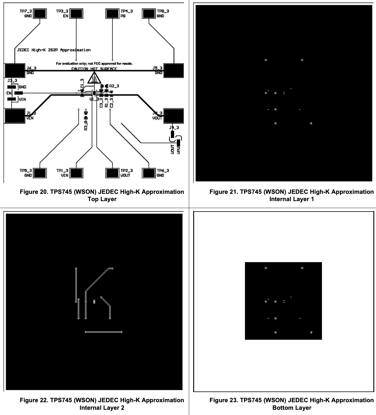

My customer asks about board condition where thermal resistance was measured on datasheet for 8pin package.
I saw SLVAE85, but it describe information only for 6pin package.
Q.1) Thermal via condition for datasheet Thita-Ja spec for 8pin package
Could you provide number for thermal via?
Is it same as described in 8.1.6, 2x1 array ot thermal vias of 300-um diameter and 25-um Cu plating?
Q.2) For TPS745-Q1, can you share similar information in SLVAE85 with 8pin package?

    For Q1, our thermal data is base on a JEDEC Standard High-K PCB. The application note http://www.ti.com/lit/an/slvae85/slvae85.pdf you refer to makes it clear that the JEDEC Standard High-K PCB is not optimal for thermal performance. The reason we use the JEDEC standard is that it is the best way to make a comparison between devices.
    Fro Q2, I have been working to bring up a thermal tool for all of our devices that can help estimate the performance. An example of this is here. Until this tool is updated, the best way is to build a board and test the performance.

    According to description in Table 1 of SLVAE85–February 2019, JEDEC High-K board has no "Additional" thermal vias.
    Does this mean no thermal via is implemented in JEDEC High-K board?

    In SLVAE85, it shows the JEDEC High-K (2s2p 2 signal, 2 power planes), It is not easy to see, but there are no thermal vias under the package:
    The optimized layout shows thermal vias both underneath and in the copper plane surrounding the package:
    So to answer your question, yes, there are no thermal vias on the JEDEC board.
