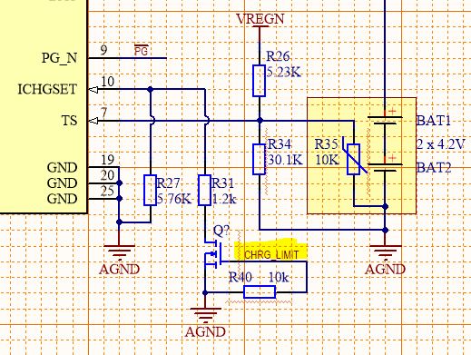

Hello Dears,
I was wondering if I can dynamically control charge current through resistors. Please find my schematic.
With other words, does the BQ25886 IC reacts immediately, when resistor value is changed dynamically, or input source detection/qualification event must be occurred in order to set charge current?
Also please one more question:
Is the toggling of dedicated charge enable pin forces BQ25886 IC to repeat input source detection algorithm?
Vahram
