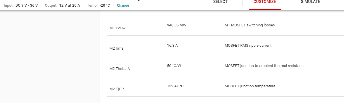

use WEBENCH® POWER DESIGNER  ,
Input:
DC 9 V - 36 V
Output:
12 V at 20 A
Temp:
30 °C
 but
Design cannot be created!
Your preferred device does not work with the inputs you selected.
OpVal table param temperature > 150°C
Please change your inputs or select another device.

  • Hello User,
    Please note that the design fails for your condition as it violates the maximum junction temperature of 150C.Also the junction temperature of FETS violate the limit.
    You can create the design for the same condition by reducing the ambient temperature to -20C or below than that as this would reduce the temperature of those devices by that amount.
