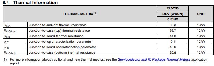

TLV759P: About thermal information
Part Number: TLV759P
Could you tell me about the thermal information data acquisition conditions?
Please tell me the board area and PCB information when this data was obtained.
Customers want to compare their information with their own board size or PCB.
Yusuke
  • Hi Yusuke-san,
    The thermal data is created using a JEDEC standard High-K board. Here is an application note showing that a JEDEC Standard HIgh-K board is not an optimal layout. The reason we use the JEDEC standard is to make it easier to compare performance between devices.
    I hope this helps.
