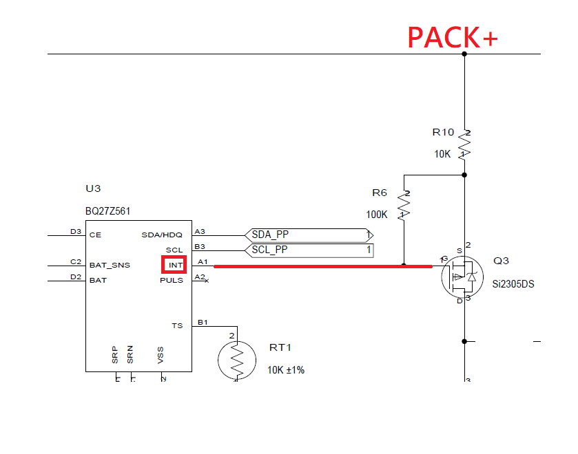

Excuse me , bq27z561 use int pin to control p-mosfet ? Is it possible to do this ?
Hi Steven,
Yes it's possible to use the INT pin in the circuit you have to turn on a PMOS. Can you explain the purpose of the circuit? INT pin can work with an NMOS as well and it can be configured open-drain or push-pull.
hanks for your reply !

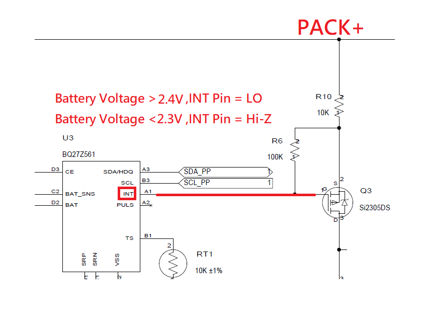

I want to set int_pup to open-drain .
When the battery voltage is higher than 2.4V , INT Pin output to LO , Then p-mos turns on.
When the battery voltage is lower than 2.3V , INT Pin to HI-Z , Then p-mos turns off.
All I can think of is to set INT_PUP to 0 to open the drain.
INT_POL set 0 is active LO.
INT_TYPE set 0 is level-type.
INT Voltage Low Set Threshold = 2.3V.
INT Voltage Low Clear Threshold =2.4V.
Can it be used like this ?
