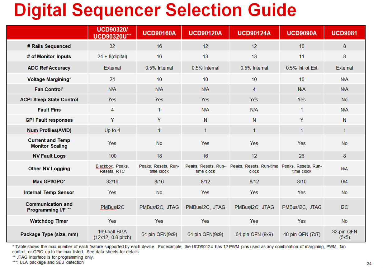

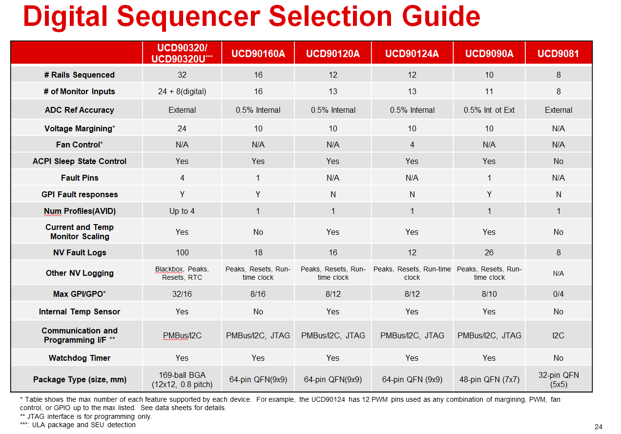

Can you give the different references of programmable power sequencers please ?
