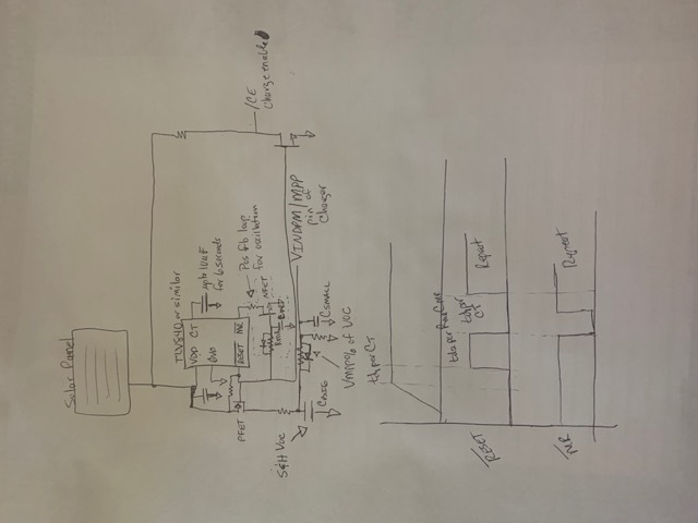

  • Hi Will,
    The BQ24650 has a fixed VINDPM treshold as a % of the current input voltage, not open circuit, voltage.  There is no sampling.
    You can diode OR 5V supply and 5VOC, 4V MPP solar cell.  The charger simply limits the charge current if the voltage it senses at its input drops to that threshold, presumably ~4V for a 5Voc cell.
    Regarding power path, this IC does not have that feature.  I would recommend adding another diode from battery back to the input rail.
    A better option might be the BQ24250 or BQ24253 with similar fixed, resistor settable VINDPM(MPP) threshold.
    I have an idea for creating a discrete sample and hold circuit, for sensing solar panel VOC, by using an SVS like as an oscillator. I built and tested an SVS as an oscillator but I have not implemented a full sample and hold circuit.  The VMPP as a % of that open circuit voltage would still be fixed.  But if you want to make it adjustable as a function of temperature, you can use the idea presented at the app note below, using series thermistors with the VINDPM/MPP resistors.
    https://www.ti.com/lit/an/slua586a/slua586a.pdf
    Jeff
