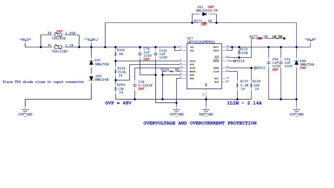

Hi TI support team
We have designed with LM76202-Q1 for automotive protection.
but so far, we have tested in Lab and got failure with ISO16750 Test A (without centralized load dump suppression), and follow TI's document, seem this part only test with Test B of ISO16750.
So, could you please help to advise us some additional passive component for pass Test A ISO16750 with LM76202-Q1
our cct like below
