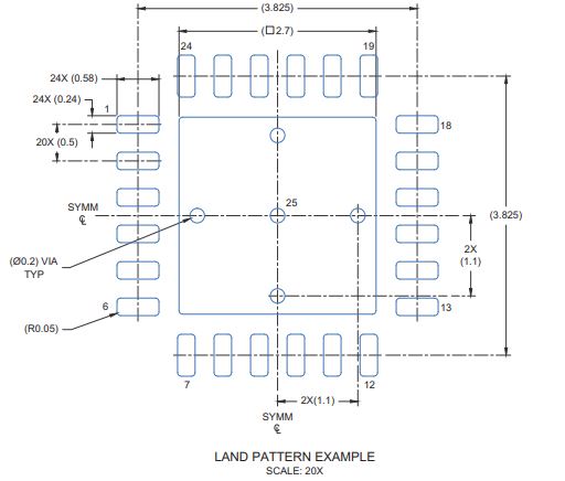

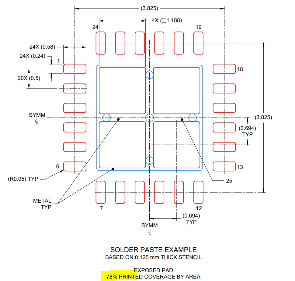

Could you tell me about TPS16630RGET metal mask for mounting?
Is there an ideal aperture ratio for a metal mask opening relative to a pad?
Or Is there a target value (xx%) for the bonding ratio between the thermal electrode and the pad on the board?
