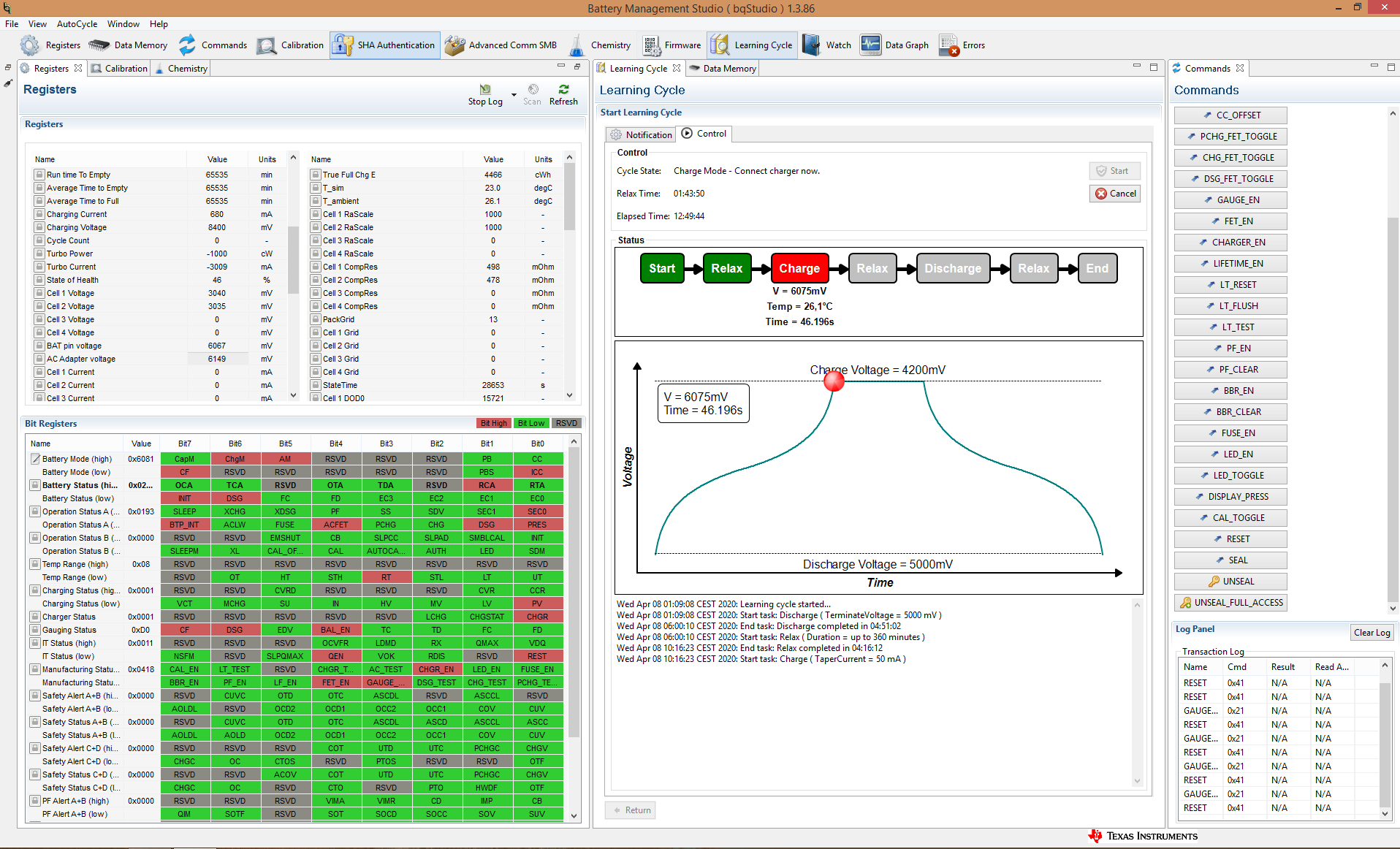

  Hi there,
Steps that i have done:
  1. choose the chemID 2059 for INR18650MJ1
  2. configure the "Data Memory"
  3. run the "Calibration" – Current Calibration and Voltage Calibration, Temperature Calibration was not done
  4. start a "Learning Cycle"
    1. DISCHARGING
      1. when "Learning Cycle" was started -> press GAUGE_EN and RESET at "Commands" view, so that QEN = high/red and RDIS = high/red
      2. start discharging DC load
      3. relaxing after discharging or wait until REST = high/red
I'm performing a learning cycle with a batterypack (2S2P of INR18650MJ1 chemid 2059) and it seems that step 4. a. - DISCHARGING was succesfully (but something strange happens – while Discharging NSFM was high/red in IT Status (low) register).
Now the learning cycle says "Charge Mode - Connect charger now.", so i connect my lab power supply (9V@3,4A) and the message does not changed.
Then i'm looked at the "DashBoard" and see there is no current flowing. The "Registers" view show that the bit ACLW at "Operation Status A" Register is high/red.
After changing the voltage at 9,7V the bit ACLW at "Operation Status A" Register is low/green and the ACFET is high/red, the bit CHGR at "Charger Status" register change from low/green to high/red.
At the "Registers" view i'm observing that the "AC Adapter voltage" is 6149mV.
1. Question: What does NSFM or Negative Ra Scale Factor Mode mean? Was step 4. a. successfully?
2. Question: Why the gauge does not charge the batterypack? Is the data memory not configured properly?
Could someone help me please?
here a screenshot and some data
